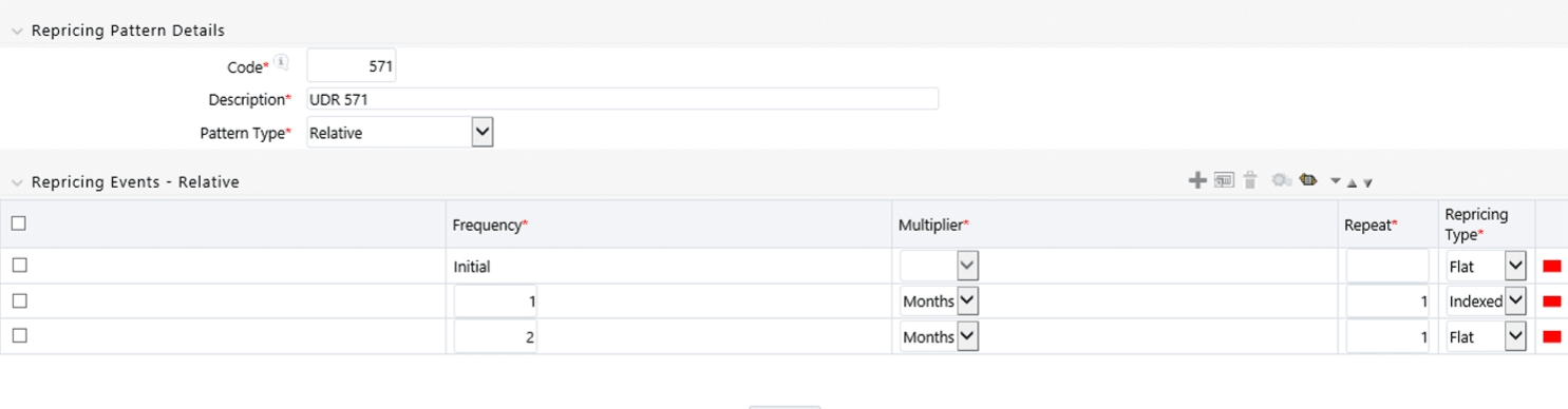

17.2.2 Define Relative Repricing Patterns
The Relative Repricing Pattern is used for instruments where the repricing is determined by the elapsed time since origination. Defining a Relative Repricing Pattern involves the definition of a series of repricing events applicable to a specific Repricing Pattern Code. You need to specify the length of each Repricing Period and the number of times that event should occur before calculating the next event in the pattern.
Figure 17-5 Define Relative Repricing Pattern
The steps to create relative repricing patterns are similar to creating absolute repricing patterns.
The only difference is that the fields in the Repricing Events table are different.

| Delete | This allows you to delete specific rows in the Repricing Events Table. You need to specify the following parameters in the Repricing Events Table for a Relative Repricing Pattern: |
| Frequency | In conjunction with the Multiplier drop-down menu, this field allows you to specify how often Repricing occurs. |
| Multiplier |
The unit of time applied to the frequency. The choices are: Days Months Years |
| Repeat | This allows you to specify the number of times a repricing event should be repeated. |
| Repricing Method | A drop-down list, it displays the Repricing Type, Flat Rate or Indexed Rate, associated with a particular event. |
After defining the above details, click Define. The Event summary Page is displayed. Note the status indicator turns from Red to Green indicating that details for the event have been defined.
