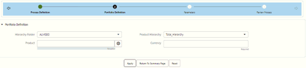

    Figure 21-4 Product Definition section
  5. Enter the following Portfolio Selection details:
    • Hierarchy (Folder): Select the Folder from which you want to pick the Hierarchy.
    • Product Hierarchy: You can specify some processing parameters at product-currency combination. Hierarchies in the selected Folder will be listed and you can select one from the available list of Hierarchies.
    • Product: Select the product. This field shows the Product list based on any node/leaf or any combination.
    • Currency: Select the Currency. The Currency drop-down displays the list of active currencies. You can select multiple currencies as well.

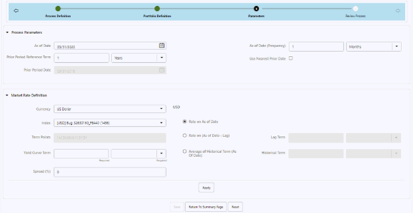

    Figure 21-5 Parameters section
    Parameters section
  7. Enter the Parameters as shown in the following table:
    Table 21-1 List of Parameters details used for Creating Data Creation Process
    Parameter Description
    As of Date As of Date and prior period reference term allows you to define the period. By default, As of Date is picked from Application Preferences. Here, you can change this date if required.
    Prior Period Reference Term As per the prior period reference term (default value 1 Year), the prior period date is auto calculated.
    Prior Period Date Displays the Prior Period Date. You cannot edit this field as it is calculated as per the Prior Period Reference Term.
    As of Date (Frequency)
    The Default value of this field is 1 month. As of Date (Frequency) is provided to select any value in days, months, or years as 1 Day, 3 Months, 1 Year, and so on. So, starting prior period date, data snaps will be taken at defined snap frequency till As of Date.
    For each date, EOD balance (CUR_PAR_BAL) for the account on Data Snap Date, Account Origination Date (which will be required to calculate account age/vintage at each Data Snap Date), and Deposit Rate (CUR_NET_RATE) will be captured, along with market-rate as per the index selected.
    Use Nearest Prior Date If Use Nearest Prior Date checkbox is selected, the system picks the nearest date (current period as of date) as per the last successful Run (default checked). If it is selected, then you cannot edit the prior period reference term field and the Prior Period Date is picked from the last successful Run for the same Data Creation Process.
    Market Rate Definition
    The Market Rate Definition parameters allow you to define the Market Rate Parameters such as Index, Currency, Term Points, Yield Curve Term, Spread, and IRC Effective Date.
    • Currency: This will list down all the currencies for which the portfolio is defined in portfolio definition UI.
    • Index: As per the selected currency from the drop-down; all the interest rate curves defined will be given for selection. Users can choose one from which market rate will be picked.
    • Term Points: Shows the term points.
    • Yield Curve Term: As per the selected interest rate curve, the user can choose one term point, the rate corresponding to the selected term point will be picked. For intermediate-term points interpolation is done.
    • Spread: Default value is 0. This field accepts all positive, negative integers/decimals in the range of -100% to +100%), you can enter the spread in a percentage format. Enter the spread in percentage on top of the rate picked from the selected IRC and term point.
    • IRC Effective Date: Rates will be picked as per the IRC effective date selected on one of the following options:
      • Rate on As of Date: Effective Date is same as As of Date.
      • Rate on (As of Date- Lag): Effective date is As of Date minus some lag. If you select Rate on (As of Date- Lag), then the Lag Term field will be enabled to enter term and tenor.
      • Average of Historical Term (As Of Date): Effective date is not just one date, but a period starting As of Date; over which arithmetic average will be taken to smooth out any interest rate fluctuations If you select Average of Historical Term (As Of Date), then the Historical Term field will be enabled to enter term and tenor.
