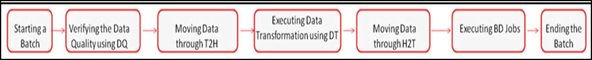

Process Flow for AAI H2T
The following figure shows the process flow for AAI H2T:
Figure 3-3 Process Flow for AAI H2T
Starting a Batch
Ensure that the staging data has the same batch date records.
To start the batch, run the start_mantas_batch.sh and set_mantas_date.sh scripts. For more information, see CTR Batch Execution.
Verifying the Data Quality Using DQ
Execute the Update_DQ_Tables.sql file available in the FIC_HOME path on the ATOMIC schema database.
Data Quality (DQ) is a check that is done at every level based on the FSDM table. When data is moved from CSA to FSDM, a check is done on CSA. This check is done in order to move only useful data into the FSDM table. For example, a column in FSDM should not be blank if it is mandatory. These checks are also called rules.
The following data quality checks are done:
  • Length Validation Check: If the length of data in source column is more than the length of target column, then an error message is generated. For example, if the ACCT_INTRL_ID column, which has a column length of 50 characters, needs to be populated from the source table column V_ACCOUNT_NUMBER, which has a few data with length more than 50 characters. An error message is raised.
  • Domain Check: If any data does not qualify for the domain values, then an error message is generated. For example, if the valid value that column ADDR_USAGE_CD accepts is one of M|B|L|A|O|P|D|H|X|V, but the source column V_ADDRESS_PURPOSE_TYPE_IND has additional values such as E or C. An error message is raised.
  • Mandatory Check: If a column which must have a value for the record to be valid has a null value, then an error message is generated. For example, if the column ADDR_STRT_LINE1_TX needs to have a value for the record to be valid and is mapped to the source table column V_ADDRESS_LINE1. If the column ADDR_STRT_LINE1_TX has a null value, an error message is raised.
  • Threshold Test: If a target table column must have a value that is greater than 0 but has a value of 0, then an error message is generated. For example, if the target table column LDGR_AM must have a value that is greater than 0 but the source table column N_LEDGER_BAL has a value as 0 or null, an error message is raised.
In addition to these data checks, another data check is done for duplicate data during data loading through AAI H2T.
Moving Data through T2H
Data is exported or moved from the Oracle RDBMS to the hive database using AAI T2H. For moving data through T2H, the T2H batch must be executed from RefData_Source with the following parameters:
  • [EXEC_ENV_TARGET]=<hive_infodom_name>,which is the ICC batch parameter
  • "EXEC_ENV_TARGET”,”<hive_infodom_name>”,which is the batch parameter if the batch is running through RRF.
For more information on moving data through T2H, see the .
Executing Data Transformation using DT
The Data Transformation (DT) functionality allows you to delete the existing data in the AAI. For more information, see Adding Tasks to a Batch.
Moving Data through H2T
Data is exported or moved from the hive database to Oracle RDBMS using AAI H2T. For more information on moving data through H2T, see the Oracle Financial Services Analytical Applications Infrastructure User Guide.
Executing Behavior Detection Jobs
After the data quality check, data transformation, and data movement through T2H and H2T is completed, execute the following jobs:
  • BD Transformation jobs. For more information, see BD Derived Datamap Types.
  • Scenario jobs. For more information, see Scenario Threshold Editor.
  • Scenario post-processing jobs. For more information, see About Post-Processing.
Ending the Batch
To end the batch, run the end_mantas_batch.sh script and the DT. For more information, see CTR Batch Execution.
