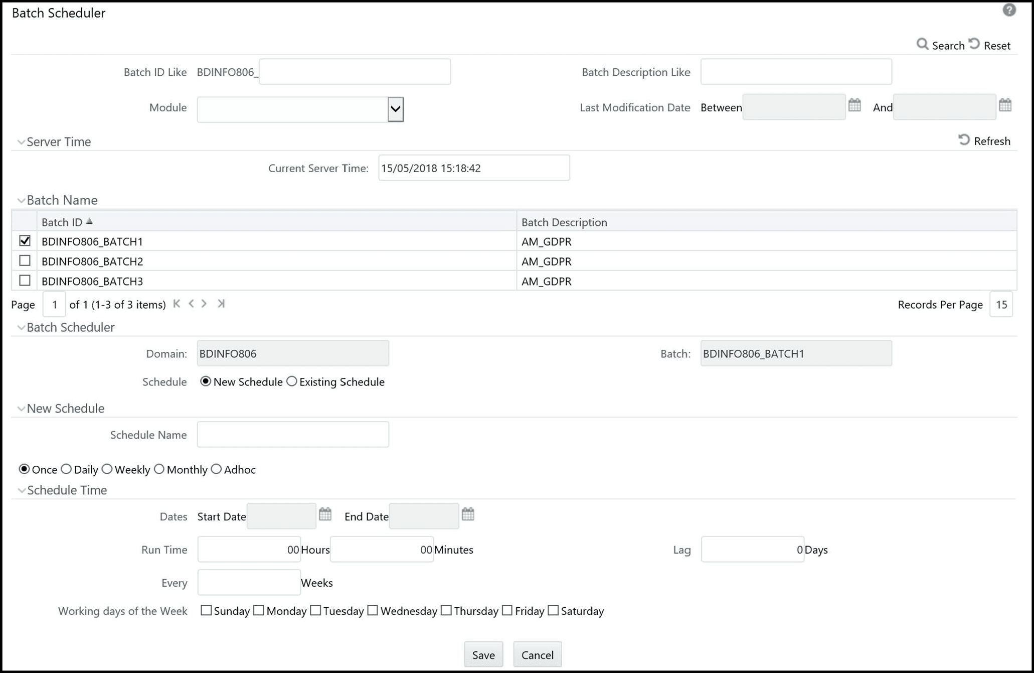

  7. Enter the schedule time of the batch by specifying the Dates, Run Time, Every, Working days of the Week information.
    Figure 10-3 Scheduling a Weekly Batch
  8. Click Save. The batch will run at the specified date and time.
