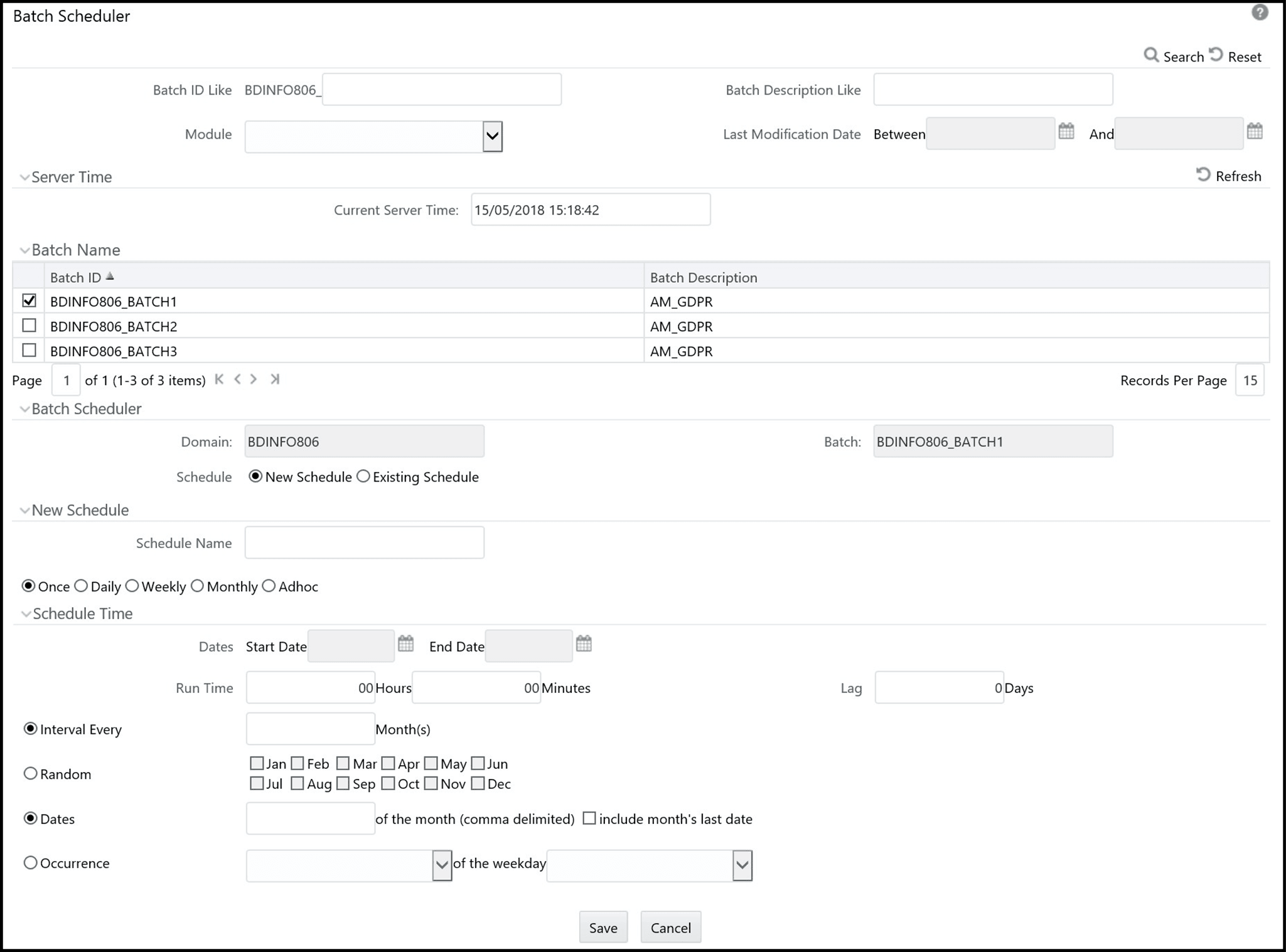

  6. Set the frequency of the new schedule as Monthly.
  7. Enter the schedule time of the batch by specifying the Dates and Run Time information.
    Figure 10-4 Scheduling a Monthly Batch
  8. Click Save. The batch will run at the specified date and time.
