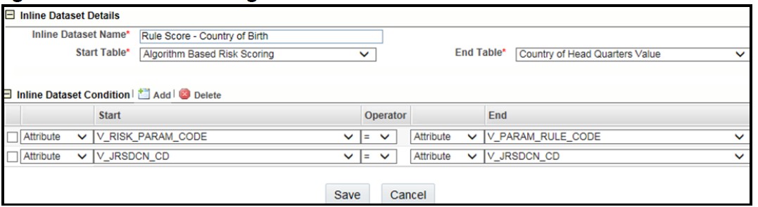

To create a join for Algorithm-based Risk Scoring to Country of Birth, follow these steps:- On the Inline Datasets page, click Add.
- Enter a name for the inline dataset.
- In the Start Table field, select Algorithm Based Risk Scoring.
- In the End Table field, select Country of Head Quarters Value.
- Click Add.
- Select the values for the dataset condition as shown in the above figure.
- Click Save. The new dataset is added to the list of Inline Datasets on the Inline Datasets page.

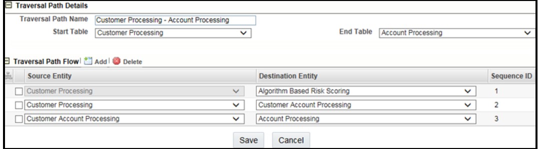

- Add a traversal path for each join defined in the Inline Datasets sub-menu. For example, Customer Processing to Customer Account Processing through Algorithm Based Risk Scoring.
- To add a traversal path, follow these steps:
- Click the Traversal Paths sub-menu in the Association and Configuration menu.
- On the Traversal Paths page, click Add.
- Enter a name for the traversal path.
- In the Start Table field, select Customer Processing.
- In the End Table field, select Account Processing.
- Click Add.
- Select the values for the traversal path flow as shown in the figure.
- Click Save.
The new path is added to the list of traversal paths on the Traversal Paths page. For more information on the datasets and traversal paths used in KYC, see the Association and Configuration chapter in the Inline Processing Engine User Guide.
- The first two rows (joins) are mandatory. The remaining joins differ based on where the new parameter is stored.
- If the start table is Customer Processing, as in the above figure, there are usually three joins. More joins may need to be added based on how many tables data is spread across.

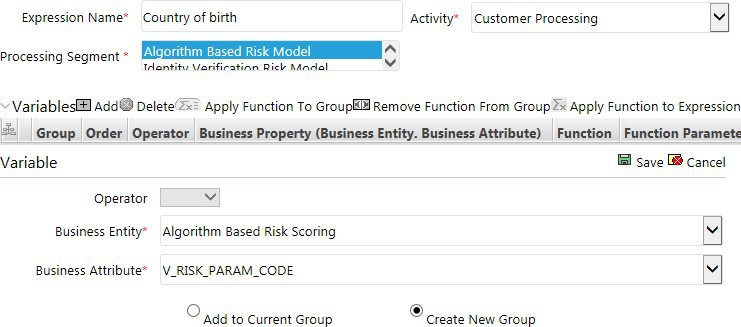

- Add an Expression on the risk score column of the newly created business entity which is to be scored as a risk parameter from the Expressions menu. Two expressions need to be created:
- The first expression is for the column which holds the value of the new risk parameter
- The second expression is for the calculations that are needed to derive the risk score
The business entity used in this example is the Method of Account Opening.To add an expression, follow these steps:- Click the Expressions menu.
- On the Expressions page, click Add.
- For the first expression, enter a name for the expression and select the values as shown in the following figure.
Figure 9-3 Expressions Page - First Expression
- To add a variable for the first expression, click Add.

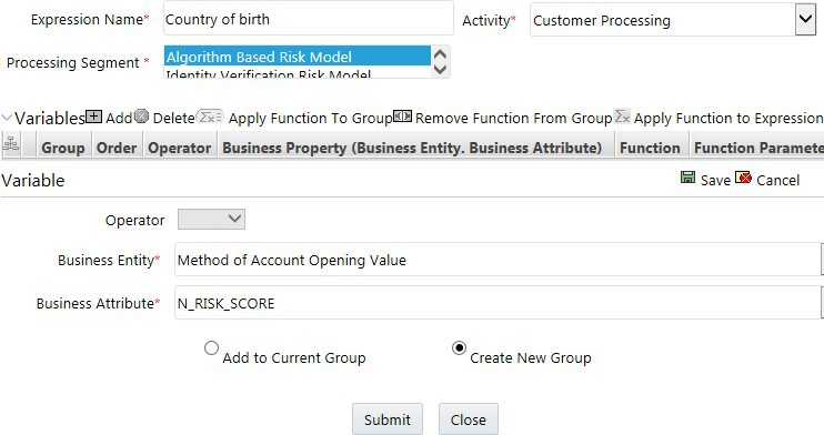

- Select the business entity and the business attribute where the value of the new parameter resides.
- Click Save. The variable is displayed.

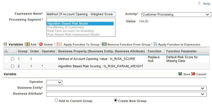

- For the second expression, enter a name for the expression and select the values as shown in the following figure.
Figure 9-4 Expressions Page - Second Expression
- To add a variable for the second expression, click Add. For the second expression, we need to add two variables: one variable is the column that holds the risk score of the parameter, and the other variable is the column that holds the risk weight for the parameter.
- For the first variable, select the values according to the Variable section in the above figure and click Save. The variable is displayed. For the second variable, select the values according to the following figure and click Save. The variable is displayed.
Figure 9-5 Expressions Page - Displayed Values
- Select the Group 1 radio button.
- Click Apply Function To Group.
- In the Apply Function To Group section, select the values according to the following figure and click Save.
- Click Submit. The new expression is added to the list of expressions on the Expressions page.

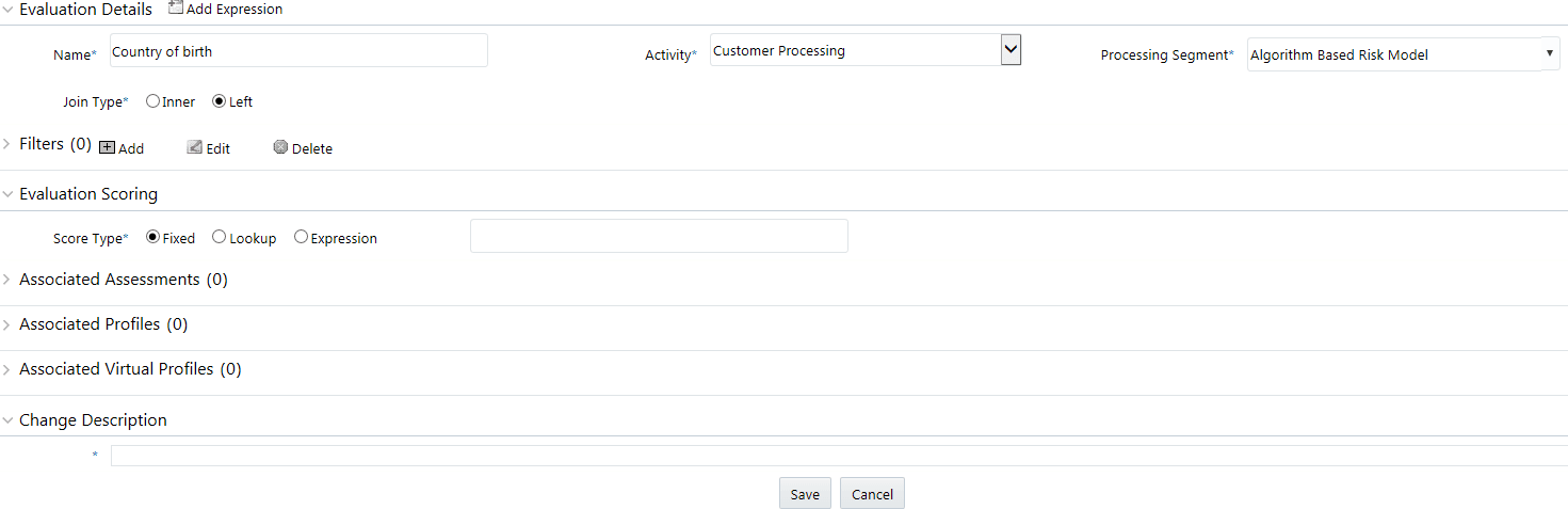

To add an evaluation, follow these steps:
- Click the Evaluations menu.
- On the Evaluations page, click Add.
- Enter a name for the evaluation.
- Select the Activity and Processing Segment field according to the following figure.
For algorithm-based risk evaluations, the join type is always left. This allows the application to provide a default risk score. - To add filters for the evaluation, click Add. You need to add two filters.

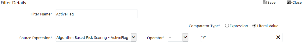

- For the first filter, select the values according to the following figure and click Save.
Figure 9-7 Filter Details - First Expression
In the Literal Value field, select the same value as provided in theF_ENABLEparameter of the APPLN_RISK_RATING_PARAMS excel sheet during upload. - For the second filter, select the values according to the following figure and click Save.

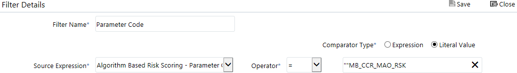

In the Literal Value field, select the same value as provided in the V_RISK_PARAM_CODE parameter of the APPLN_RISK_RATING_PARAMS excel sheet during upload. - Select the expression that you have created for the calculation of the risk score.
