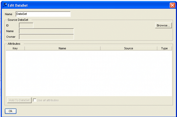

  2. Double-click the DataSet Source icon.
    The Edit DataSet dialog box displays.
    Figure 5-7 Edit DataSet Dialog Box
  3. Click Browse in the Edit DataSet dialog box to select a source dataset. The Select DataSet dialog box displays.
  4. Select the desired dataset from the Datasets area.
  5. Click OK.
    The Edit DataSet dialog box displays the DataSet ID, Name, Owner, and Attributes.
