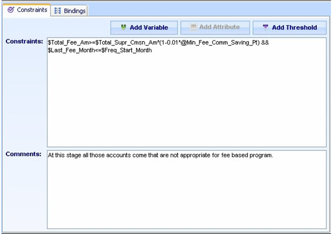

Constraints Tab
The Constraints tab enables you to specify constraints for a primary and any sub-rules you add to a rule pattern.
Figure 8-8 Edit Rule Dialog Box—Constraints Tab
The Constraints tab contains the following elements:
  • Constraints: Specifies the exact criteria that the rule search must meet for matches to result. This fields requires a C-like syntax.
  • Comments: Provides additional information about the constraint defined within the rule.
  • Add Variable: Indicates the variables defined earlier in the pattern used to build your constraint. When clicked, a list displays all variables defined in the current rule or previous rules.
  • Add Attribute: Specifies the attribute within the specified dataset used to build your constraint. When clicked, a list displays all related attributes from which you can select.
  • Add Threshold: Specifies the thresholds within the scenario used to build your constraint. When clicked, a list displays all thresholds defined for the scenario.

  5. Specify a constraint by doing any of the following:
    1. Click the Add Attribute button to select attributes you want as part of a constraint.
    2. Not applicable for Primary Rule: Click the Add Variable button to select variables you want as part of a constraint.
    3. Click the Add Threshold button to select thresholds you want as part of a constraint.
  6. Click Ok.
    The Constraints displays attributes, variables, and thresholds in the order added.
    Optional: Type any details you want to add to the constraint in the Comments field.
  7. Click Ok.
    The constraint string displays in the Constraints.
