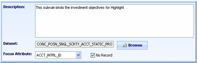

8.4.1.3.2 Rule Description: Sub- Rule
The Sub-Rule Description enables you to specify element values for any sub-rules you add to the rule pattern.
Figure 8-7 Edit Rule Description Fields—Sub-Rule
The Primary Rule Description contains the following elements:
- Description: Enables you to specify the purpose of a rule or any desired information that relates to a rule.
- Dataset: Enables you to select a source dataset that contains the attributes that you want to use in the rule pattern.
- Focus Attribute: Enables you to select the focus attribute for a rule.
- No Record: Enables you to set a rule so that its key ID is not recorded and shown as a building block on the Web Application pages. The default setting (not selected) records the rule.
