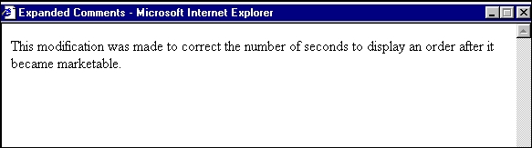

Viewing Expanded Comments
- Click the ellipsis (...) at the end of the comment in the Scenario
Threshold inset.
The entire comment, up to 4,000 characters, displays in the Expanded Comments dialog box.
Figure 8-3 Example Expanded Comment Dialog Box
- Click Close (X) on the top right corner to close the dialog box.
