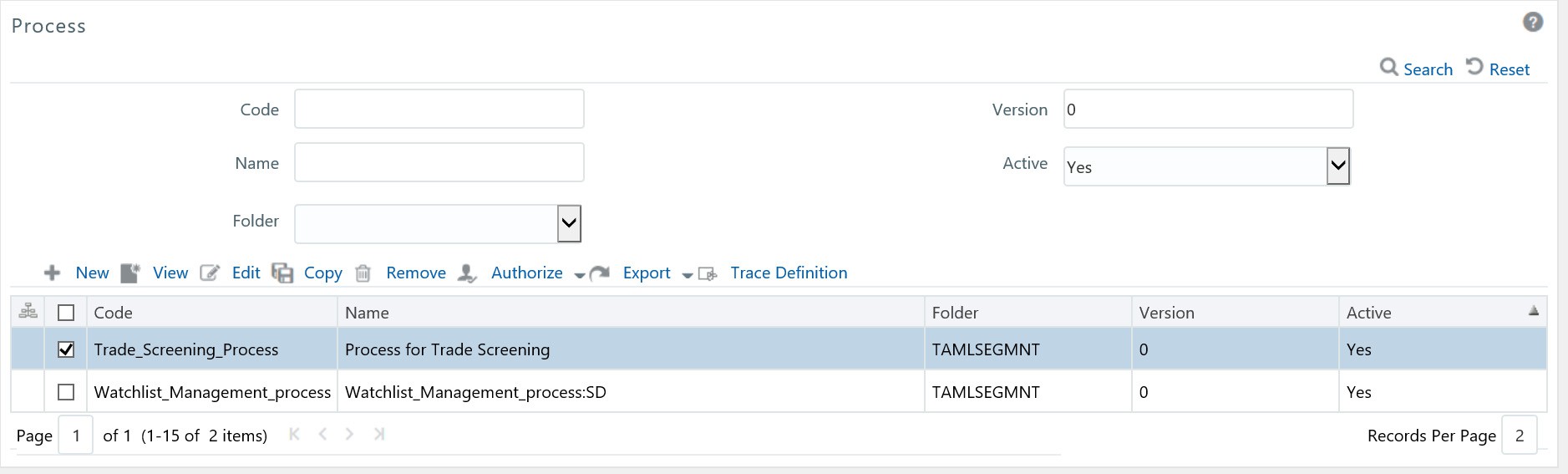

  4. Click Process. The Process page is displayed with the available applications.
  5. Select an application from the Code column and click Edit. The Process Definition page is displayed with the process or processes associated to this application.

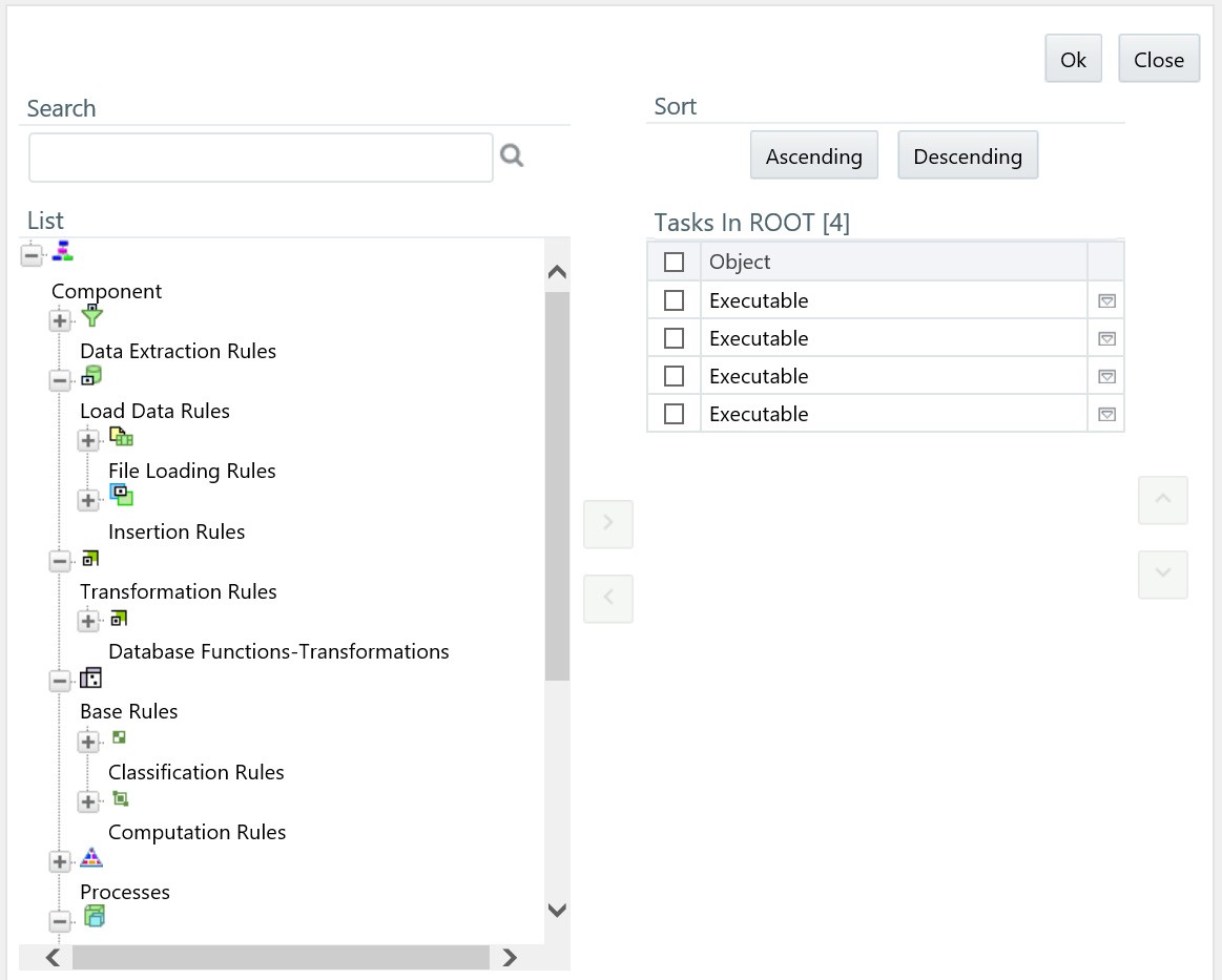

  8. Click Component. The Component Selector window is displayed.
    Figure 5-23 Component Selector page
  9. Click Parameters option. The Parameters window is displayed. The following are default parameters:
    "","","ALL","END",""
    • Source Batch for Correlation
    • ALL: is the component. Modify the component if required.
    • END: is used to end the batch.
  10. Modify the parameters and click OK.
