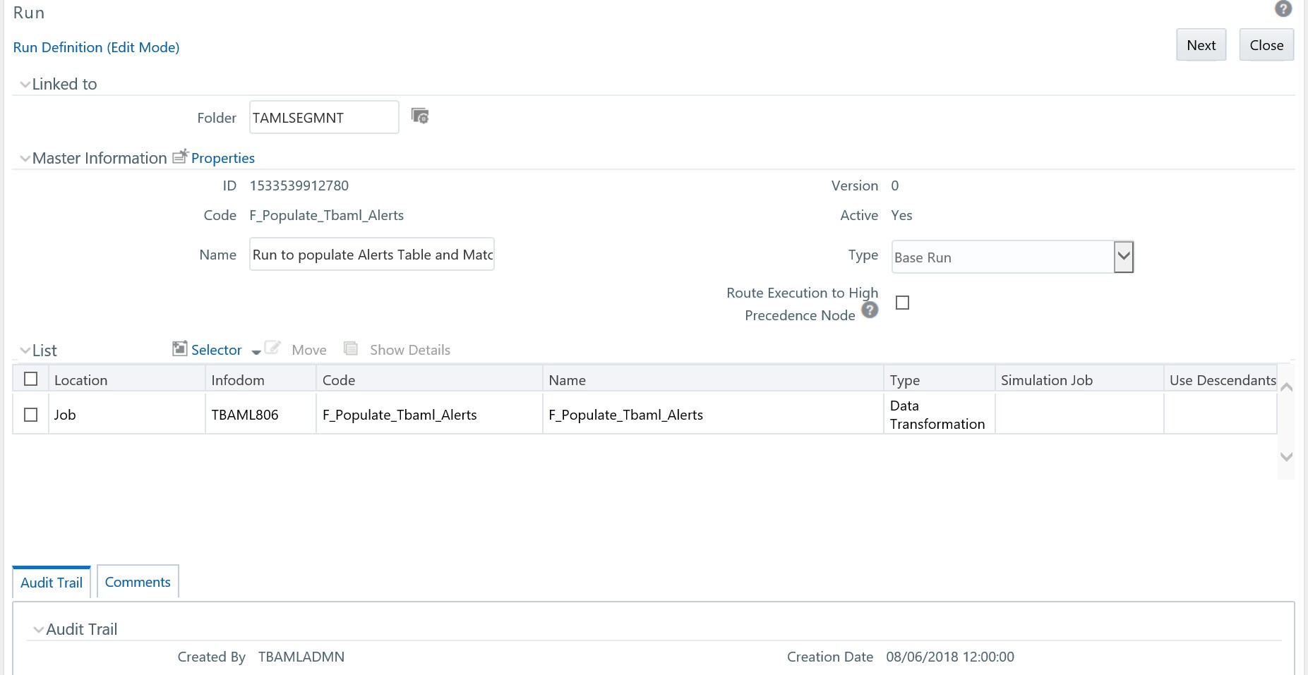

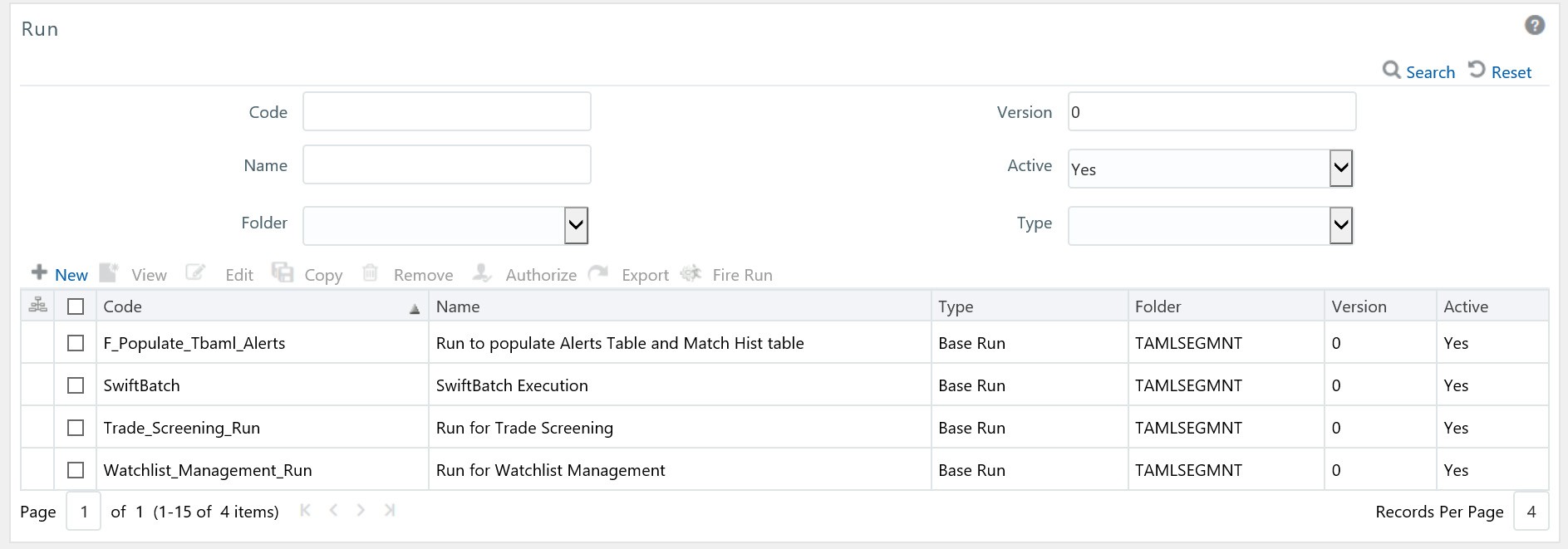

  4. Click Run. The Run page is displayed with the available applications.
  5. Select an application from the Code column (for example, F_Populate_Tbaml_Alerts) and click Edit. The Run Definition page is displayed with the process or processes associated to this application.
    Figure 5-18 Run Definition page
  6. Select the job or jobs for the batch and click Next. The Detail section is populated. Complete your edits and click Save.

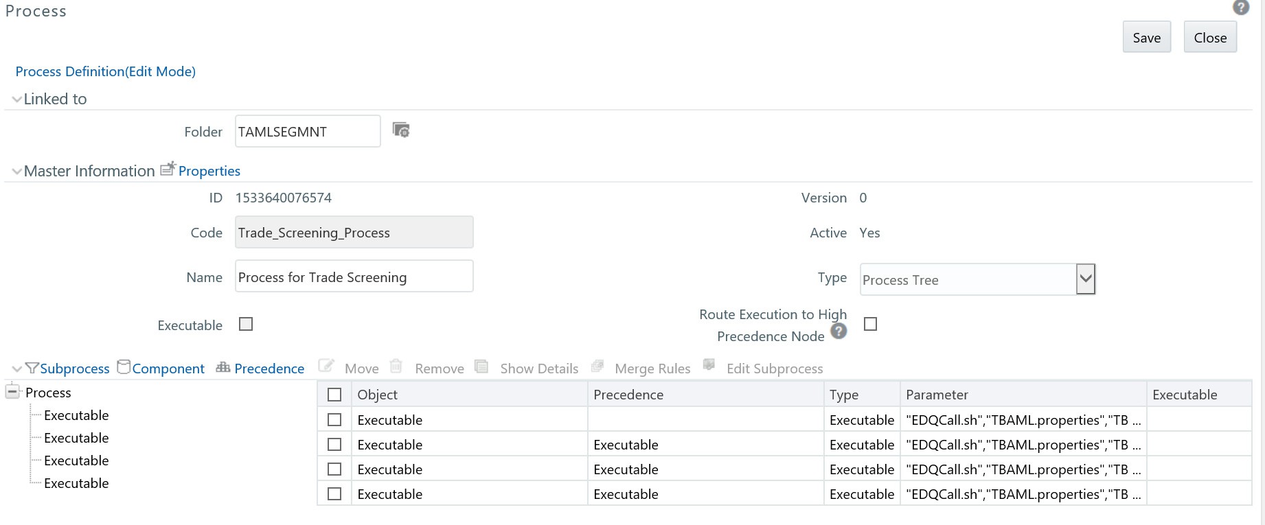

  7. In the Navigation List, select Process to open the Process page.
  8. Select an application from the Code column and click Edit. The Process Definition page is displayed with the process or processes associated to this application.
    Figure 5-20 Process Definition page
