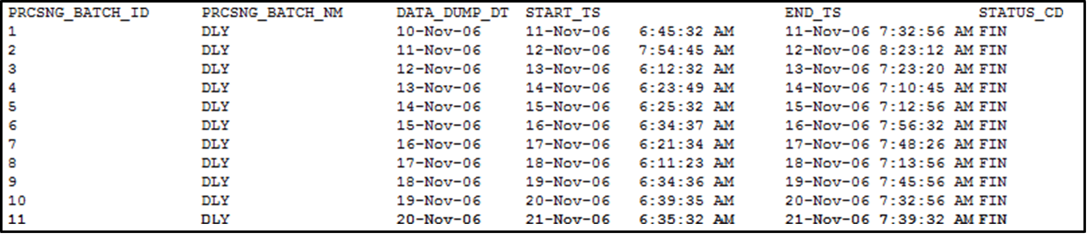

  2. Records information about the batch in the KDD_PRCSNG_BATCH_ HIST table. This table contains a history of all batches that appear by start date and end date. The following sample illustrates a table query; an end time-stamp in END_TS and status of FIN in STATUS_CD for the bolded entry indicates that the batch has ended.
    Figure 7-3 Sample KDD_PRCSNG_BATCH_HIST Table—Batch End Status
