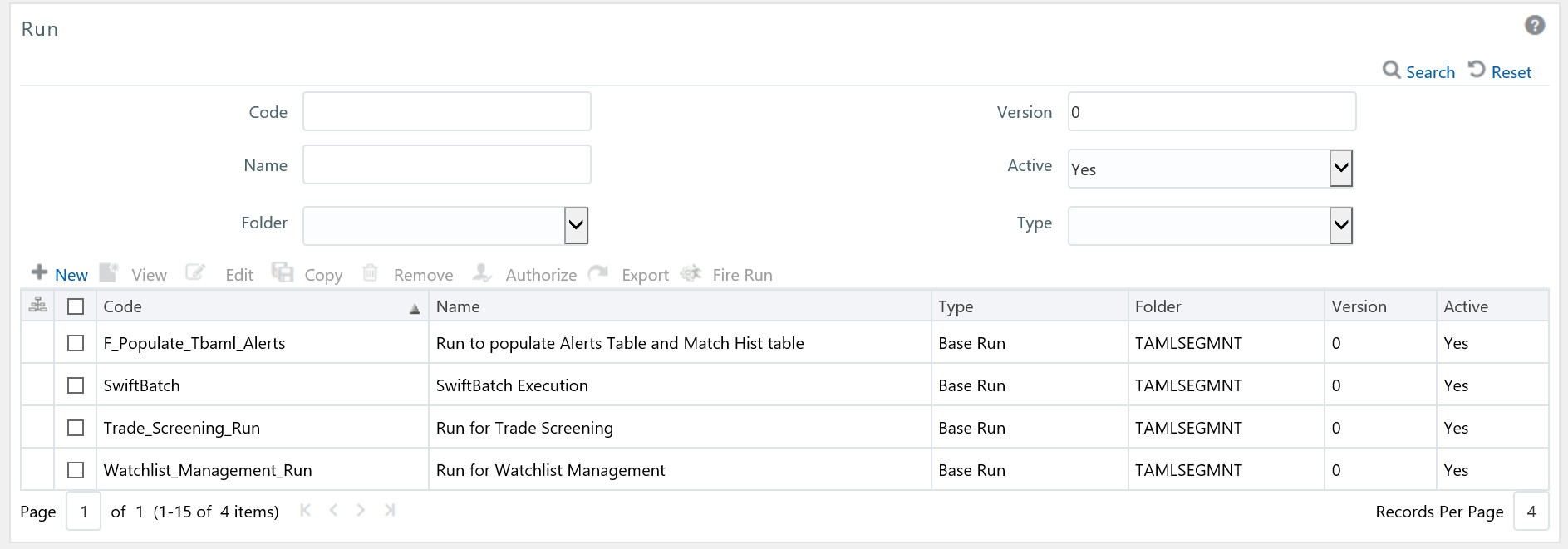

  1. Login as the Administrator. The OFSAAI Applications page is displayed.
  2. Click Trade Based Anti Money Laundering.
  3. In the Navigation List, select Operations, then click Run Rule Framework.
  4. Click Run. The Run page is displayed with the available batch jobs.

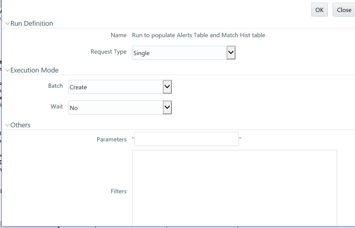

  5. Select the batch job that is to be executed and click Fire Run. The Fire Run window is displayed.
  6. Enter the following details:
    Table 5-7 Adding Fire Run Details
    Field Description
    Request Type Select Request Type based on the following options:
    • Single: If the batch must be executed once.
    • Multiple: If the batch must be executed multiple times at different intervals.
    Batch Select Batch. It has the following options:
    • Create
    • Create & Execute
    From these options, select Create & Execute.
    Wait Select Wait. It has the following options:
    • Yes: This executes the batch after a certain duration. Enter the duration as required.
    • No: This executes the batch immediately.
    Parameters Enter the parameters for this batch.
    Filters Enter the filter details.
    Note: $MISDATE option can be used to execute the run for that particular day. The format for it to enter in the filter details is: to_date(<ACTIVITY_TABLE_NAME>.<ACTIVITY_DT_COL>)=$MISDATE
    Note: For $MISDATE option:
    • For either Date or Timestamp datatypes, to_date is mandatory for the filter.
    • Activity Table Name and Activity Column Name should be in capital.
  7. Click OK to run the batch. The following message is displayed: Batch Execution is in progress.
