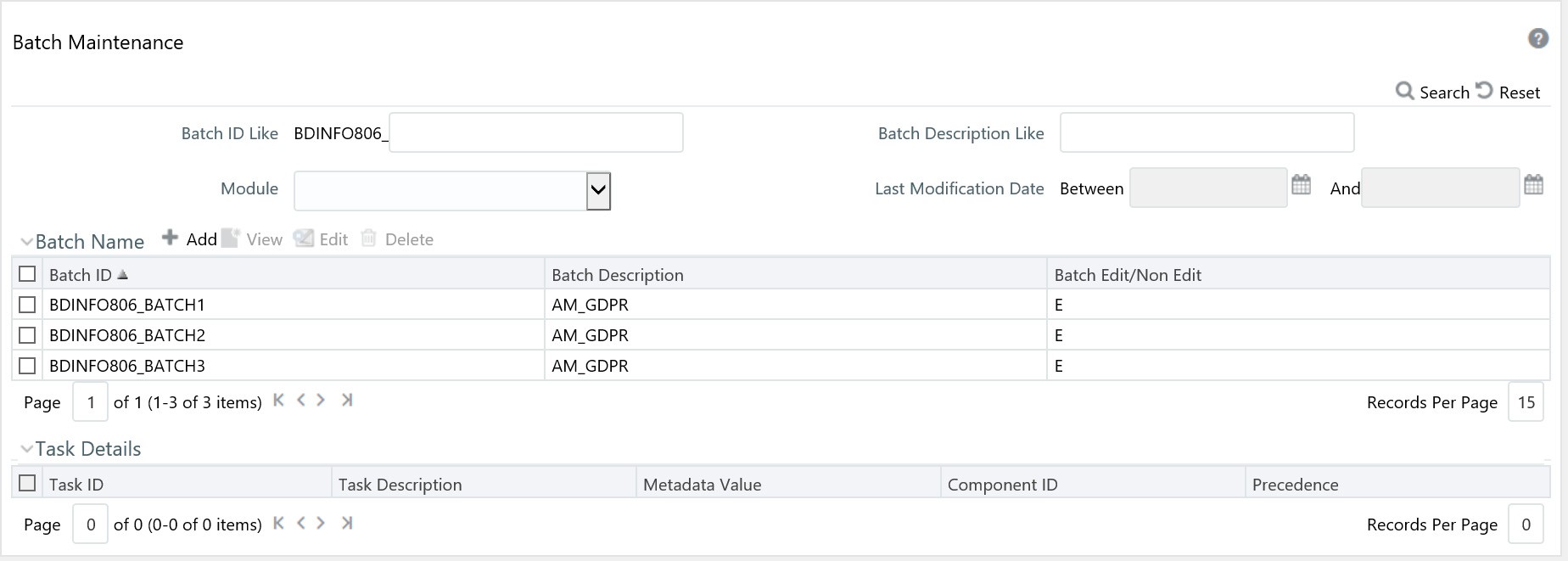

  3. In the Navigation List, select Operations, then Batch Maintenance. The Batch Maintenance page is displayed.
    Figure 5-4 Batch Maintenance page
  4. In the Batch Name section, select the batch that you want to set task precedence for.
  5. In the Task Details section, click

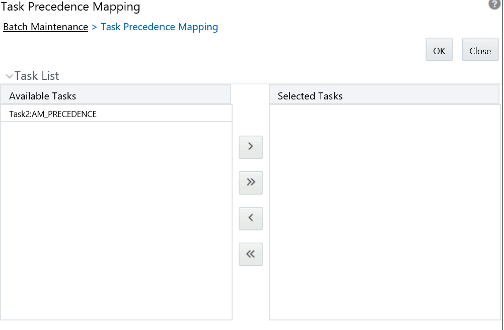

    . The Task Precedence Mapping window is displayed.
    Figure 5-5 Task Precedence Mapping
  6. Move the tasks which must be executed prior to this task from the Available Tasks pane to the Selected Tasks pane.
  7. Click OK after you have selected all tasks which must precede the task. The selected tasks are listed in the Precedence column of the Task Details section.
