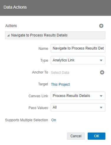

The Data Actions provide the capability to perform drill down analysis across the downstream report canvases. The drill down is enabled via a data action.

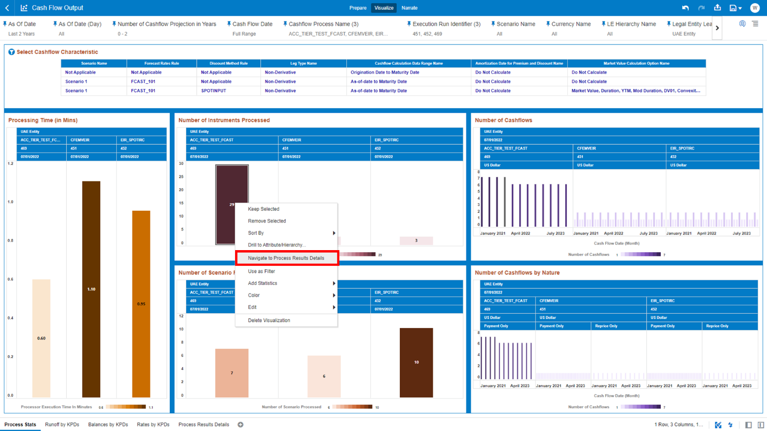

From every report canvas charts, you can select a combination of values, and then perform the navigation to the “Process Results Details” report canvas.
In order to do so, with a right click on the chart selection, the data action options will appear for you to be able to navigate further as described in the following mapping:
  • Navigate to Process Results Details – the Data Action will be drilling through the “Process Results Details” canvas.
The following screenshots show the Data Action list as well as the navigation options that appears once you right click on the desired selection.
Figure 8-14 Data Action configuration
Figure 8-15 Data Action for Drill down with report Canvases
