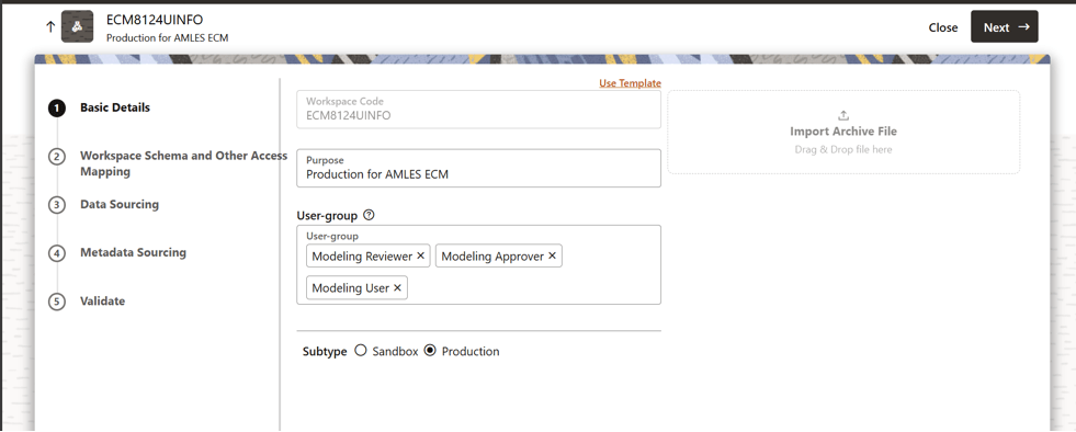

Basic Details
To create a basic details of the production workspace, follow these steps:
  1. Enter the Workspace Code and Purpose of the workspace.
    Provide the workspace name same as ECM Infodom name.
  2. From the drop-down list, select the User-group.
  3. Select the subtype as Production.
  4. Click Next.
    Figure 5-68 Basic Details

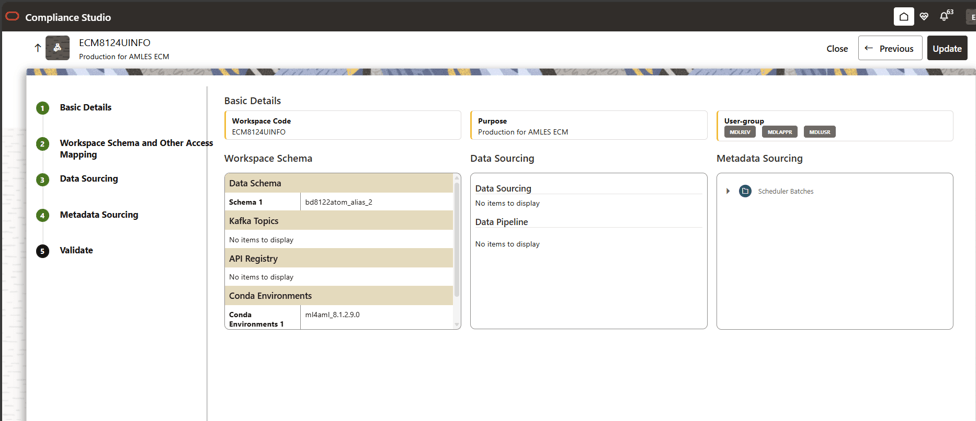

Validate Workspace
You can validate the Basic details, Workspace schema, Data Sourcing and Metadata sourcing before you physicalize the workspace.
To Physicalize the workspace, Click Finish and then select Physicalize Workspace.
Figure 5-71 Physicalize Workspace
Summary
You can view summary of the created workspace.
