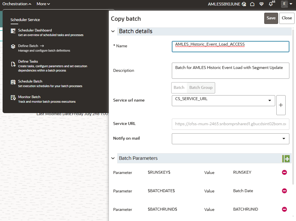

    1. In the Compliance Studio Orchestration sub-menu, select Define Batch to open the Define Batch page. On this page, click the Copy Batch icon to clone the existing AMLES_Historic_Event_Load batch.
      The batches must to be cloned with a new name so that the original batches are not changed as part of any product level upgrade in the future.
      Figure A-36 The Copy Batch Window

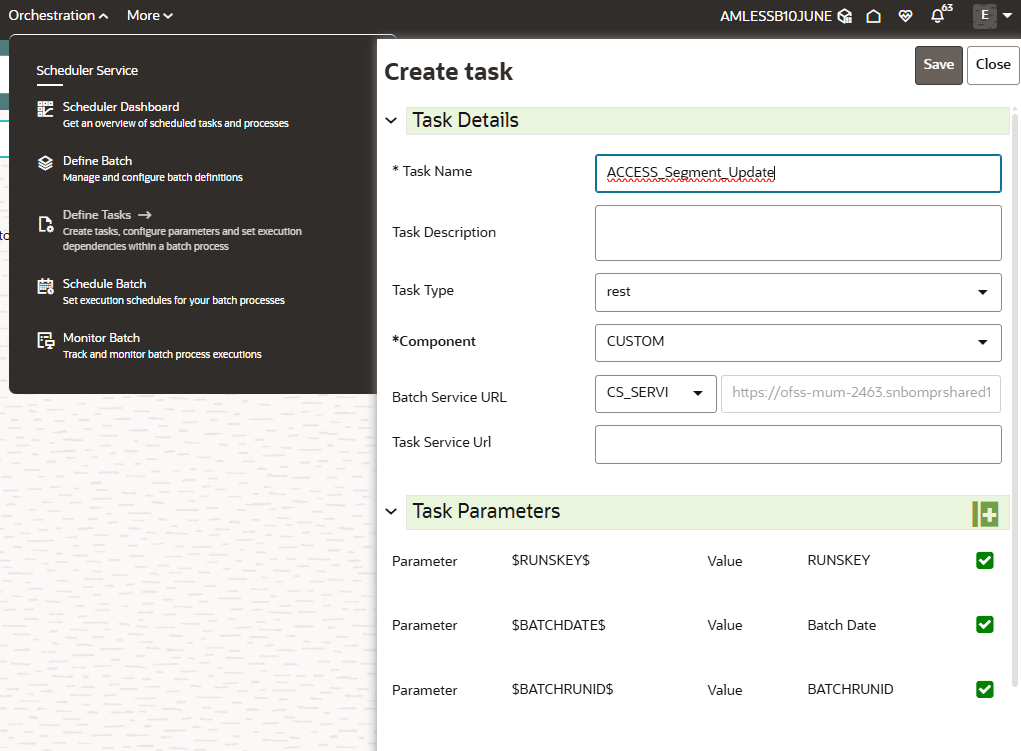

    2. Select the Orchestration sub-menu, and then click Define Task to open the Define Task page. On this page, click the Create Task icon to create an additional task in the AMLES_Historic_Event_Load batch.
      Figure A-37 The Create Task Window
      This task will have the following parameters :
      Table A-19 Task Parameters
      Task Parameter Value
      Component MODEL
      Objective Objective of the New Champion notebook
      Model CHAMPION
      Synchronous Execution YES

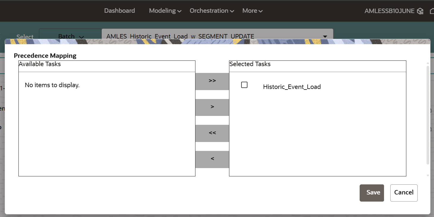

    3. After successfully creating the task, the precedence must be set by clicking the Menu icon that corresponds to the desired task in the following way:
      In the AMLES_Historic_Event_Load batch, the new task should be positioned to run after the Historic_Event_Load task.
      Figure A-38 Precedence Mapping Window
