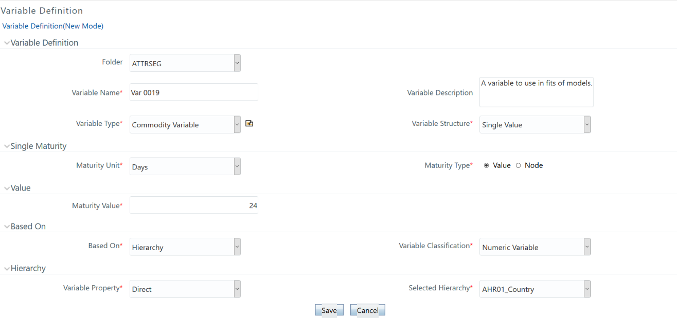

    Figure 8-2 Variable Definition window
    This image displays the Variable Definition window.
  2. Enter the Variable details as described in the table in the Adding Variable Definition section in Managing Stress Testing.
    The fields marked in red asterisk (*) are mandatory.
  3. Click Save to upload the new Variable Definition details.
