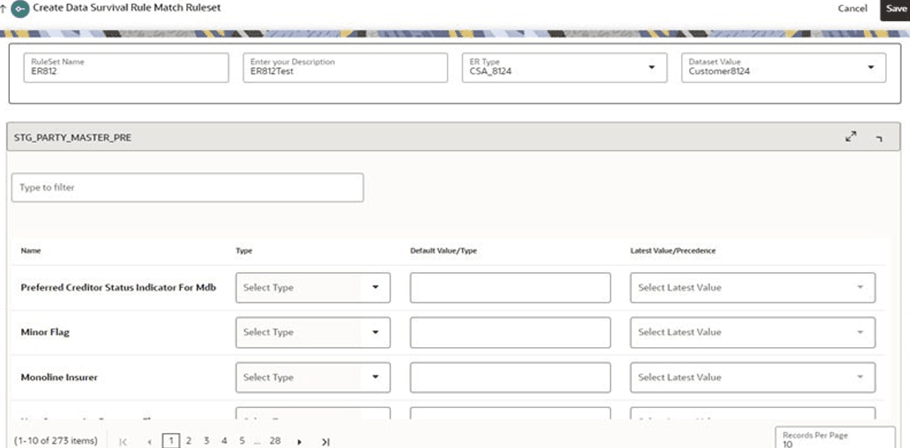

    Figure 9-13 Create Data Survival Rules
  3. On the Create Data Survival Rule Match Ruleset page, perform the following:

  4. You can select the following method types used to store the final record.
