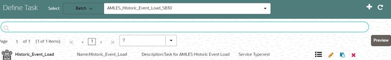

The batch contains a single task named Historic_Event_Load.
Figure 5-69 Task Details for Historic Event Load
Historic_Event_Load, Task Parameters

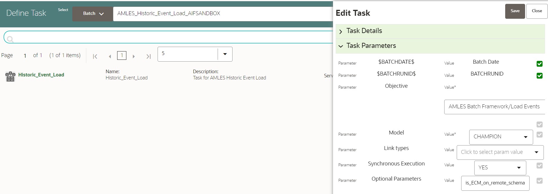

  • Objective folder for this task :
    Home / Modeling / Pipelines / AMLES Batch Framework / Load Events /
    AMLES Data Load
  • Do not change any parameter, except Optional Parameters.
  • Optional Parameters:
    • Event date range: from_date=YYYY-MM-DD,to_date=YYYY-MM-DD
    • is_ECM_on_remote_schema: Flag indicates ECM Schema is on different schema or not. Options True or False
    • enable_debug_mode: enable debug mode or not. Options True or False.
      Example : is_ECM_on_remote_schema=True,from_date=2001-01-01,to_date=2022-01-01
  • Edit Task Parameters & Save.
