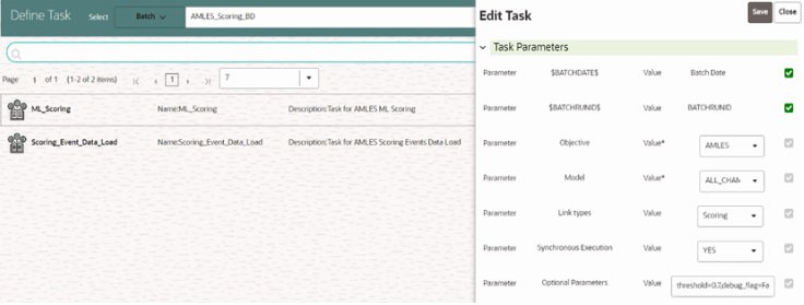

  • Optional Parameters:
    • threshold: Input threshold or cutoff to create events. Events will be created if the score of an entity exceeds the threshold. Example: 0.7
    • debug_flag: flag to set for debugging purpose. Few records will be selected.
      Options: True or False
    • Optional Parameters can be edited from the Schedule Batch option.
    • Do not change any batch/task parameters, except Optional Parameters.
    • Choose Link Types as Scoring.
      Figure 5-72 Edit Task for AMLES_Scoring
