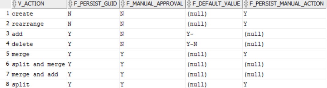

When global parties change (parties are added or removed), the system can be configured to either create a new global party id or to keep one of the existing ids depending on need to preserve global party in downstream systems.
The fcc_er_guid_persist_config table contains the configuration for Global Party ID Persistence.
The following table describes column/flag deatils in the FCC_ER_GUID_PERSIST_CONFIG.
Table 4-2 FCC_ER_GUID_PERSIST_CONFIG
| Column Name/Flag | Description |
| V_ACTION | It represents the different actions that can be
performed on the Global Party ID. The possible actions are:
| F_PERSIST_GUID | This flag represents whether the Global Party ID should
be persisted or not whenever it undergoes change in an ER batch. The
valid values are Y and N. The GUID is persisted if the flag is set to Y
for the particular action.
Note: This flag is not applicable for create and rearrange actions as these are manual actions. |
| F_MANUAL_APPROVAL | This flag represents manual approval is required when
GUID undergoes change in an ER batch. The valid values are Y and N. If
the flag is set to Y, then user gets the request to approve the changes
in the UI.
For more information, see the Pending - System Requests Tab section in the OFS Compliance Studio User Guide. |
| F_DEFAULT_VALUE | This flag represents the default value that will override the values present in the F_PERSIST_GUID and F_MANUAL_APPROVAL flags. |
| F_PERSIST_MANUAL_ACTI ON | This flag represents whether the Global Party ID can be
persisted or not through manual action. The valid values are Y and N.
The GUID is persisted if the flag is set to Y for the particular action.
If the flag is set to N, then new Global Party ID will be created.
Note: This flag is applicable only for Merge, Split, Create and Rearrange actions. |
- Only the flags in F_PERSIST_GUID and F_MANUAL_APPROVAL should be modified. F_DEFAULT_VALUE should not be modified for any action.
- For add and delete actions, the GUID always persists irrespective of the user input in the F_PERSIST_GUID flag.
- For delete action, manual approval is not required irrespective of the user input provided in the F_MANUAL_APPROVAL flag.
- If F_PERSIST_GUID and F_MANUAL_APPROVAL flags for the split action are set to Y and Y respectively, then flags for split and merge action will also be considered as Y and Y regardless of the user input. Similarly, If F_PERSIST_GUID and F_MANUAL_APPROVAL flags for the split and merge action are set to Y and Y respectively, then flags for the split action will also be considered as Y and Y regardless of the user input.
Figure 4-11 fcc_er_guid_persist_config table
