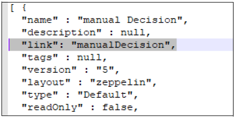

  8. What should I do if there is a below Error while selecting edges in manual DecisionUI?
    java.lang.IllegalStateException: Unable to create PgxSessionWrapperjava.lang.IllegalStateException: Unable to create PgxSessionWrapper at oracle.datastudio.interpreter.pgx.CombinedPgxDriver.getOrCreateSession(C ombinedPgxDriver.java:147) at
    oracle.pgx.graphviz.driver.PgxDriver.getGraph(PgxDriver.java:334) at oracle.pgx.graphviz.library.QueryEnhancer.createEnhancer(QueryEnhancer.j ava:223) at oracle.pgx.graphviz.library.QueryEnhancer.createEnhancer(QueryEnhancer.j ava:209) at oracle.pgx.graphviz.library.QueryEnhancer.query(QueryEnhancer.java:150) at  oracle.pgx.graphviz.library.QueryEnhancer.execute(QueryEnhancer.java:136
    ) at oracle.pgx.graphviz.interpreter.PgqlInterpreter.interpret(PgqlInterprete r.java:131) at oracle.datastudio.interpreter.pgx.PgxInterpreter.interpret(PgxInterprete r.java:120) at org.apache.zeppelin.interpreter.LazyOpenInterpreter.interpret(LazyOpenIn terpreter.java:103) at org.apache.zeppelin.interpreter.remote.RemoteInterpreterServer$Interpret Job.jobRun(RemoteInterpreterServer.java:632) at org.apache.zeppelin.scheduler.Job.run(Job.java:188) at org.apache.zeppelin.scheduler.FIFOScheduler$1.run(FIFOScheduler.java:140
    ) at java.base/ java.util.concurrent.Executors$RunnableAdapter.call(Executors.java:515) at java.base/java.util.concurrent.FutureTask.run(FutureTask.java:264) at java.base/ java.util.concurrent.ScheduledThreadPoolExecutor$ScheduledFutureTask.run (ScheduledThreadPoolExecutor.java:304) at java.base/ java.util.concurrent.ThreadPoolExecutor.runWorker(ThreadPoolExecutor.jav a:1128) at java.base/ java.util.concurrent.ThreadPoolExecutor$Worker.run(ThreadPoolExecutor.ja va:628) at java.base/java.lang.Thread.run(Thread.java:834)Caused by: java.util.concurrent.ExecutionException: oracle.pgx.common.auth.AuthorizationException: PgxUser(FCCMDSADMIN) does not own session 6007f00a-8305-4576-9a56-9fa0f061586f or the session does not exist code: PGX-ERROR-CQAZPV67UM4H at java.base/ java.util.concurrent.CompletableFuture.reportGet(CompletableFuture.java:
    395) at java.base/ java.util.concurrent.CompletableFuture.get(CompletableFuture.java:1999) at oracle.pgx.api.PgxFuture.get(PgxFuture.java:99) at oracle.pgx.api.ServerInstance.getSession(ServerInstance.java:670) at oracle.datastudio.interpreter.pgx.CombinedPgxDriver.getOrCreateSession(C ombinedPgxDriver.java:145) ... 17 moreCaused by: oracle.pgx.common.auth.AuthorizationException: PgxUser(FCCMDSADMIN) does not own session 6007f00a-8305-4576-9a56-9fa0f061586f or the session does not exist code: PGX-ERROR-CQAZPV67UM4H at oracle.pgx.common.marshalers.ExceptionMarshaler.toUnserializedException( ExceptionMarshaler.java:107) at oracle.pgx.common.marshalers.ExceptionMarshaler.unmarshal(ExceptionMarsh aler.java:123) at oracle.pgx.client.RemoteUtils.parseExceptionalResponse(RemoteUtils.java:
    130) at oracle.pgx.client.HttpRequestExecutor.executeRequest(HttpRequestExecutor
    .java:198) at oracle.pgx.client.HttpRequestExecutor.get(HttpRequestExecutor.java:165) at  oracle.pgx.client.RemoteControlImpl$10.request(RemoteControlImpl.java:313)
    at oracle.pgx.client.RemoteControlImpl$ControlRequest.request(RemoteControl Impl.java:119) at oracle.pgx.client.RemoteControlImpl$ControlRequest.request(RemoteControl Impl.java:110) at oracle.pgx.client.AbstractAsyncRequest.execute(AbstractAsyncRequest.java
    :47) at oracle.pgx.client.RemoteControlImpl.request(RemoteControlImpl.java:107) at  oracle.pgx.client.RemoteControlImpl.getSessionInfo(RemoteControlImpl.jav a:296) at oracle.pgx.api.ServerInstance.lambda$getSessionInfoAsync$14(ServerInstan ce.java:490) at java.base/ java.util.concurrent.CompletableFuture.uniComposeStage(CompletableFuture
    .java:1106) at java.base/ java.util.concurrent.CompletableFuture.thenCompose(CompletableFuture.jav a:2235) at oracle.pgx.api.PgxFuture.thenCompose(PgxFuture.java:158)
    You can perform the following steps as a workaround:
    Export the "Manual Decision" Notebook.
    Add the link parameter just below Description.
    For example: "link": "manual Decision",
    Truncate the table “fcc_er_paragraph_manual" in Studio Schema.
    Import the modified notebook again.

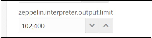

  9. What should I do when the result set is truncated if the size goes above '102400' bytes?
    Perform the following steps:
    Login to Compliance Studio.
    Navigate to interpreter zeppelin.interpreter.output.limit.
    Figure 5-2 Interpreter zeppelin parameter
    Description of Figure 5-2 follows
    Description of "Figure 5-2 Interpreter zeppelin parameter"
    Set the value to the required size.
    Restart the Studio Application.

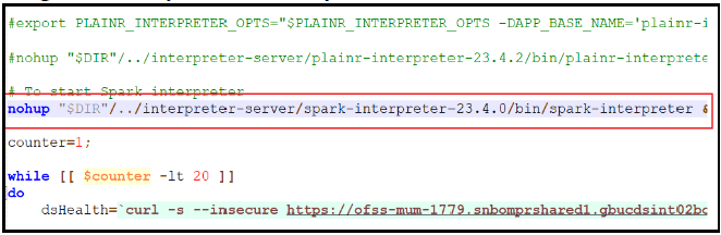

  29. How to configure a new/cloned interpreter?
    To configure a new/cloned interpreter:
    1. Create a new/clone an existing interpreter in the UI.
    2. Navigate to the <COMPLIANCE_STUDIO_INSTALLATION_PATH>/deployed/mmg-home/mmgstudio/bin directory.
    3. Open the startup.sh file and add the following line before the line containing “counter=1”;
      nohup <path_to_interpreter_binary_file> &>> <path_to_save_the_logs>/ <log_file_name>.log &
      Figure 5-3 Snapshot of startup.sh file
      Description of Figure 5-3 follows
      Description of "Figure 5-3 Snapshot of startup.sh file"
    4. Save and close the file.

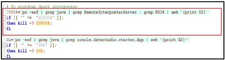

    5. Open the shutdown.sh file and add following line before the line containing “SL=”.
      I8004=`ps -eaf | grep java | grep RemoteInterpreterServer | grep 8004 | awk '{print $2}'` if [[ "" != "$I8004" ]]; then kill -9 $I8004; fi
      Figure 5-4 Snapshot of shutdown.sh file
      Description of Figure 5-4 follows
      Description of "Figure 5-4 Snapshot of shutdown.sh file"
      In the above steps, the port number for the new/cloned interpreter is assumed to be 8004, the default port that comes with the installer. If a different port is used, then change the configuration accordingly.
    6. Save and close the file.
    7. Navigate to the <COMPLIANCE_STUDIO_INSTALLATION_PATH>/bin directory.
    8. Restart Compliance Studio using the command: ./compliance-studio.sh –restart.
    9. Verify if the spark-interpreter has started using the command: netstat –nltp | grep 8004.
