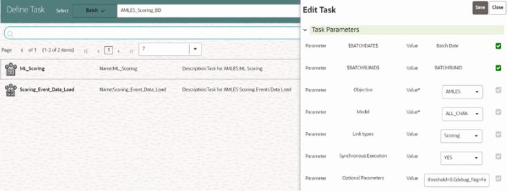

- Optional Parameters:
- is_ECM_on_remote_schema: Flag indicates ECM Schema is on different schema or not. Options True or False
- enable_debug_mode: enable debug mode or not.
Example : is_ECM_on_remote_schema=True
- Optional Parameters can be edited from the Schedule Batch option.
- Objective folder for this
task:
Home / Modeling / Pipelines / AMLES - Navigate to respective model group/scenario folders for actual model templates.
- Model: Retain the default settings.
- For a fresh installation, do not modify any parameters except Optional Parameters and Link Types.
- For upgrade, see the How to Execute Model Scoring/Annual Model Validation with the Batch Framework section.
- threshold: Input threshold or cutoff to create events. Events will be created if the score of an entity exceeds the threshold. Example: 0.7
The threshold parameter does not affect the batch. This will be deprecated in a future release. - debug_flag: flag to set for debugging purpose.
Few records will be selected.
Options: True or False
- Choose Link Types as Scoring.
