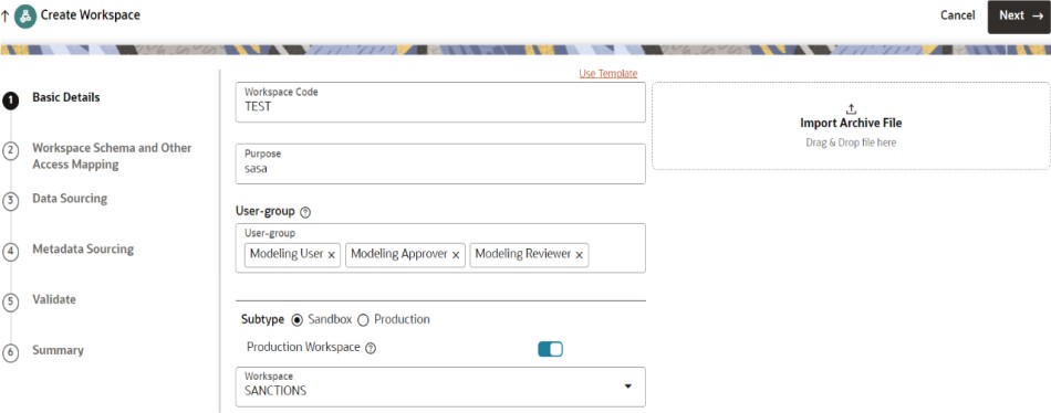

Basic Details
To create basic details of the sandbox workspace, follow these steps:
  1. Provide the requested details for Workspace Code and Purpose.
  2. From the drop-down list, select the User-group.
  3. Select the subtype as Sandbox Workspace.
  4. Enable the Production Workspace button.
  5. From the drop-down list, select the Sanction Production Workspace.
  6. Click Next.

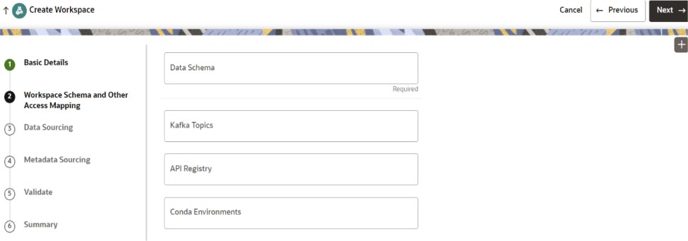

Workspace Schema
To create the workspace schema, follow these steps:
  1. Select the newly created data store as Data Schema.
    Leave the Kafka Topics and API Configurations fields as blank.
  2. Select the following Conda Environments:
    1. default_8.1.2.9.0
    2. ml4aml_8.1.2.9.0
  3. Click Next.

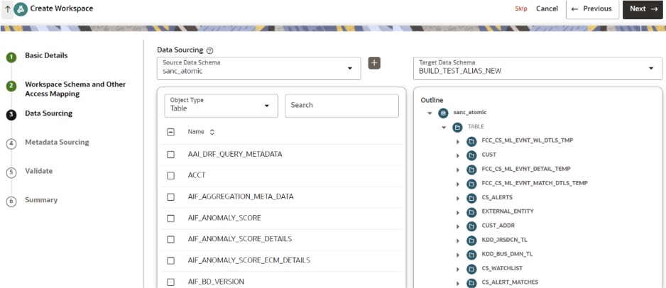

Data Sourcing
To select Database objects from the data stores, follow these steps:
  1. From the Source Data Schema drop-down list, select the Data Store.
  2. From the Object Type drop-down list, select the Table.
  3. Select following tables from the sanction production data store where it is having sufficient historical data.
    CUST
    CS_ALERTS
    EXTERNAL_ENTITY
    CUST_ADDR
    KDD_JRSDCN_TL
    KDD_BUS_DMN_TL
    CS_WATCHLIST
    CS_ALERT_MATCHES

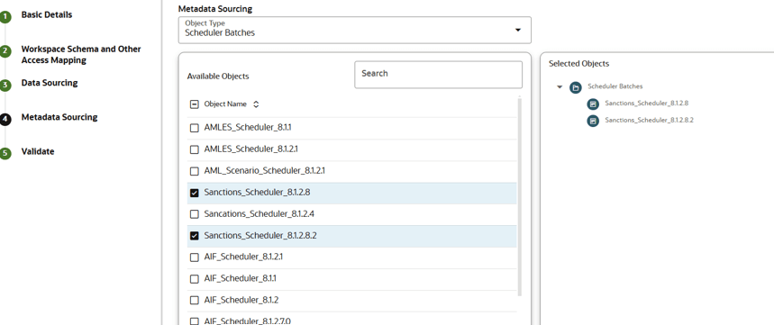

Metadata Sourcing
To select available objects from the Metadata Sourcing, follow these steps:
  1. From the Object Type drop-down list, select Scheduler Batches.
  2. In the Available Objects, select Sanctions_Scheduler_8.1.2.8 and Sanctions_Scheduler_8.1.2.8.2.
  3. Click Next.

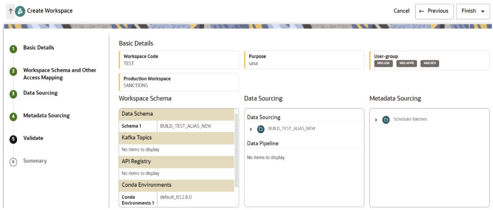

Validate Workspace
You can validate the Basic details, Workspace schema, Data Sourcing and Metadata sourcing before you physicalize the workspace.

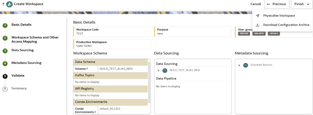

To Physicalise the workspace, Click Finish and then select Physicalise Workspace.
Figure 5-53 Physicalise Workspace

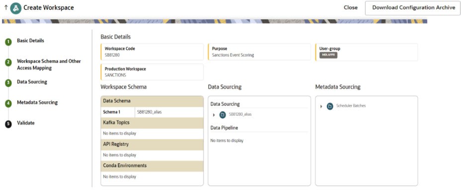

Summary
You can view summary of the created workspace
