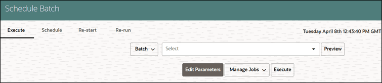

  3. Click Orchestration menu and then select Schedule Batch. The Schedule Batch page is displayed.
  4. Select the appropriate Batch Scheduler.

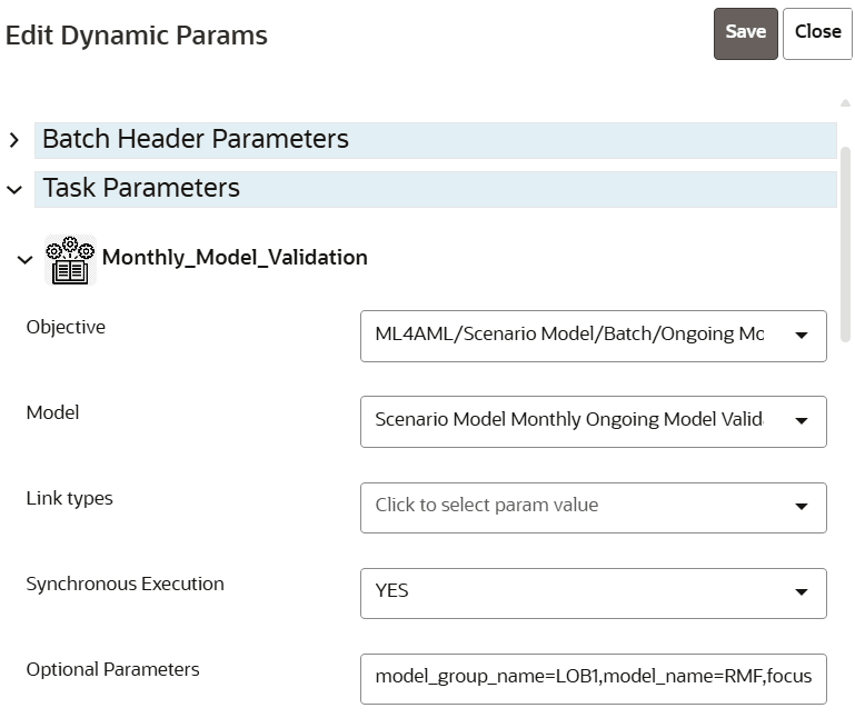

  5. Click Edit Parameters. The Edit Dynamic Params window is displayed.
    Figure A-35 Edit Dynamic Params
  6. In the Task Parameters, select Objective from the drop-down list. You need to select Data Quality and Model Drift objectives respectively for executing the batches.
    Save the Data Quality model and execute the batch. Then, repeat the same steps for the Model Drift model, and vice versa.
    For example, you need to select the following objectives for Behavioral Model.
    ML4AML/Scenario Model/Batch/Ongoing Model Validation/Monthly/Data Quality
    ML4AML/Scenario Model/Batch/Ongoing Model Validation/Monthly/Model Drift
