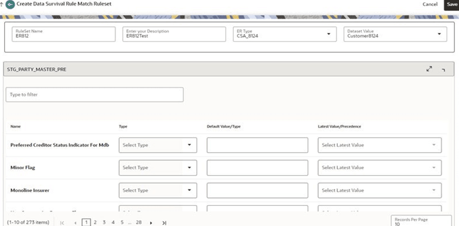

    Figure 9-13 Create Data Survival Rules
  3. On the Create Data Survival Rule Match Ruleset page, perform the following:
    • Filter the records using the search filter (Type the filter)
    • Sort the records
      To sort the records, right-click on any of the columns and select Sort > Sort Ascending or Sort Descending for ascending and descending order, respectively. The records will be displayed according to sort order.
