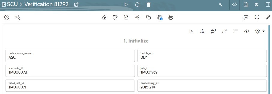

- Click the Notebook tab. The Verification Notebook is displayed.
Figure 5-19 Initialize Paragraph in the Verification Notebook
- In the Initialize paragraph, enter the following:
- datasource_name: Enter the Behavior Detection Atomic Schema data store attached to the workspace.
- batch_nm: Enter the processing batch name.
- scenario_id: Enter the scenario ID for verification.
- job_id: Enter the job id for the scenario.
- tshld_set_id: Enter the threshold set ID.
- processing_dt: Enter the processing date in the format YYYYMMDD. For example, 20241010 for 10th Oct 2024.
- Run the Initialize paragraph. After successful execution, the results are displayed in the following paragraphs.

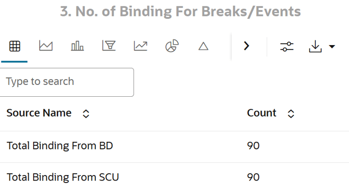

The No. of Breaks/Events paragraph displays the number of breaks/events generated in BD/SCU.
The No. of Bindings for Breaks/Events paragraph lists the number of bindings available in the BD and SCU for the generated breaks/events.

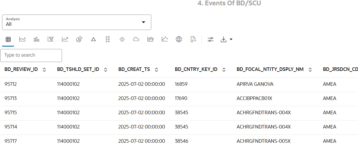

- The Events of BD/SCU paragraph displays the alerts and events available in BD and SCU. Use the drop-down list to select the desired analysis. The analyses are:
- All: Displays all events available in both BD and SCU.
- BD Side Available: Displays the lists of events available only in BD and not in SCU.
- SCU Side Available: Displays the lists of events available only in SCU and not in BD.
- Mismatch: Displays all mismatched events between BD and SCU.
- Match: Displays all matched events between BD and SCU.
- After selecting the analysis, run the Events of BD/SCU paragraph to view the event analysis.

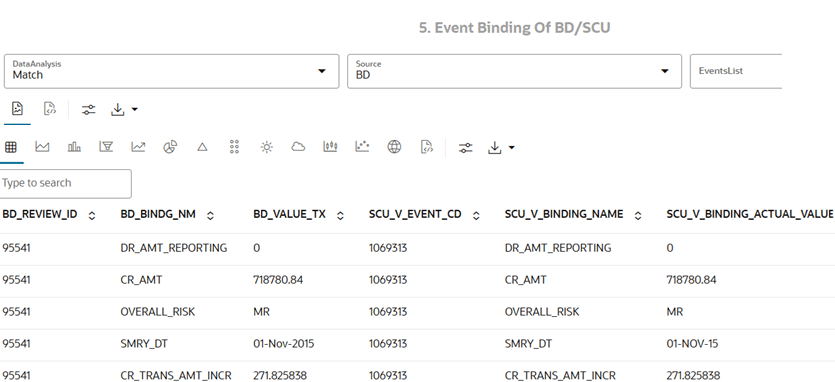

- The Event Binding of BD/SCU paragraph lists the binding information for the events.
- Use the Data Analysis drop-down list to select the desired analysis. The options are:
- Match: Displays all event bindings that match between BD and SCU.
- Mismatch: Displays all event bindings that do not match between BD and SCU.
- All: Displays all event bindings available in BD and SCU.
- Enter the Events List.
If the source is selected as BD, enter the BD_REVIEW_ID; if the source is selected as SCU, enter the SCU_V_EVENT_CD.
- Run the Event Binding of BD/SCU paragraph to view the event binding data.

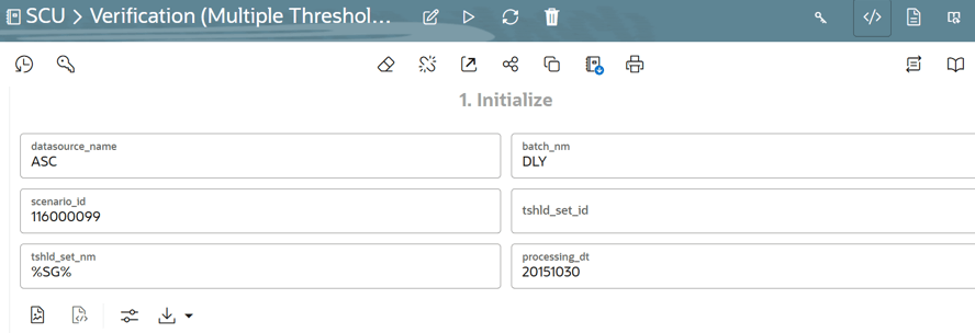

- Click the Notebook tab. The Verification (Multiple Threshold Sets) Notebook is displayed.
Figure 5-24 Verification (Multiple Threshold Sets)
- tshld_set_id: Enter the threshold set IDs, separated by commas. For example: 116000127, 118840042, 118840043.
The user can provide either the threshold set ID, or the threshold set name for verification. If both are provided, the result will display the superset of the matches. - tshld_set_nm: Enter a substring of the threshold set name using % . For example, if the threshold set name is TSHLD_SG_JR1, the user can enter %SG% as the tshld_set_nm.
- Run the Initialize paragraph. After successful execution, the results are displayed in the following paragraphs:
