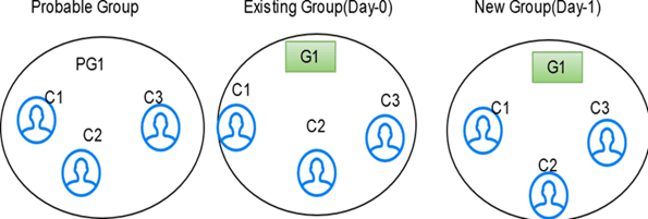

No change
Existing group elements are a subset of probable group elements, and the number of elements is the same in both groups. All elements in the existing Group have the same global id. The existing global id is assigned to probable group elements.
For example, G1 has C1, C2 and C3 entities. After the Day 1 batch execution, if there is no change in the existing group. Still, G1 has C1, C2 and C3 entities with the same global id.

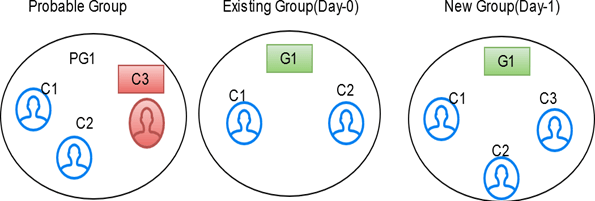

Add
Existing group elements are a subset of probable group elements, and the number of elements in the probable Group is more than the existing Group. Extra elements in the probable Group don't have any global id assigned yet. New elements are added to the existing Group, and the same global id is assigned.
For example, G1 has C1 and C2 entities. After the Day 1 batch execution, if C3 entity matches with existing group then C3 will be added to the existing group G1 with the same global id.

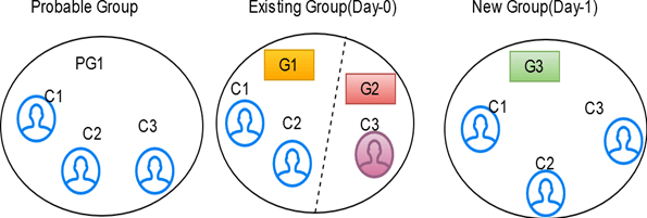

Merge
Existing group elements are a subset of probable group elements, and the number of elements is the same in both groups. Elements in the existing Group have different global ids assigned.
Elements are merged into a single group, and a new global id is assigned.
For example, G1 has C1 and C2 entities and G2 has a C3 entity. After the Day 1 batch execution, if C3 entity matches with an existing group then C3 will be merged into the existing group with a new global id assigned.

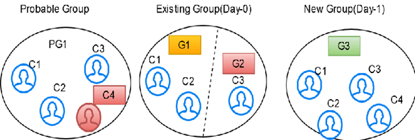

Merge and Add
Existing group elements are a subset of probable group elements, and the number of elements in the probable Group is more than the existing Group. Extra elements in the probable Group don't have any global id assigned yet, and standard elements have different global IDs assigned already. Common elements are merged into a single group, and new elements are added to the Group with a new global id.
For example, G1 has C1 and C2 entities, G2 has C3 entity. After the Day 1 batch execution, if C4 entity is added newly and C3 entity got changed then common entities are merged into a single group and a new entity is added to the group with a new global id (G3 has C1, C2, C3, and C4 entities) assigned.

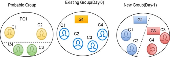

Split
After applying merging rules criteria, if multiple groups are created for elements of a probable group, these elements are also a subset of existing group elements. The number of elements in both probable and existing groups is the same. A single global id is assigned to all elements in the existing Group, and then probable group elements are split into different groups with new global ids assigned to each.
For example, G1 has C1, C2, C3 and C4 entities. After the Day 1 batch execution, if C3 and C4 entities are not matched with the existing entities of the group then C3 and C4 will be split into a new group. G2 has C1 and C2 entities and G3 has C3 and C4 entities with new global id is assigned to each group.

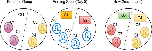

Split and Merge
After applying merging rules criteria, if multiple groups are created for elements of a probable group, these elements are also a subset of existing group elements. The number of elements in both probable and existing groups is the same, and different global ids are assigned to elements in the existing Group, then probable group elements are split into different groups and merged, satisfying the same ruleset criteria with new global ids assigned to each.
For example, G1 has C1 and C3 entities and G2 has C2 and C4 entities. After the Day 1 batch execution, if C1 matches with C2 and C3 matches with C4 then C2 and C4 will be split separately and merged with C1 and C2 respectively. G3 has C1 and C2 entities and G4 has C2 and C4 entities with a new global id assigned to each group.

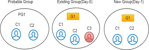

Delete
If an element exists in the existing Group, but the same element doesn't belong to any probable group and doesn't exist in the customer/entity dataset, it is deleted from the existing group with same global id assigned.If the deleted record is part of STG_DELETED_PARTIES_PRE table then underlying customers will also be deleted.
For example, G1 has C1, C2, and C3 entities. After the Day 1 batch execution, if C3 is deleted from the existing group then G1 has C1 and C2 entities with same global id.
