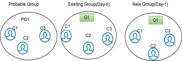

No change
Existing group elements are a subset of probable group elements, and the number of elements is the same in both groups. All elements in the existing Group have the same global id. The existing global id is assigned to probable group elements.
For example, G1 has C1, C2 and C3 entities. After the Day 1 batch execution, if there is no change in the existing group. Still, G1 has C1, C2 and C3 entities with the same global id.

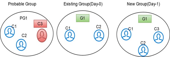

Add
Existing group elements are a subset of probable group elements, and the number of elements in the probable Group is more than the existing Group. Extra elements in the probable Group do not have any global id assigned yet. New elements are added to the existing Group, and the same global id is assigned.
For example, G1 has C1 and C2 entities. After the Day 1 batch execution, if C3 entity ma

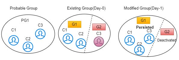

Case 1: If number of entities are different between the groups
For example, G1 has C1 and C2 entities and G2 has a C3 entity. After the Day 1 batch execution, if C3 entity matches with an existing group then C3 will be merged into the existing group with same global id is persisted and G2 will be deactivated.
Figure 4-20 Merge Action for most Number of Entities

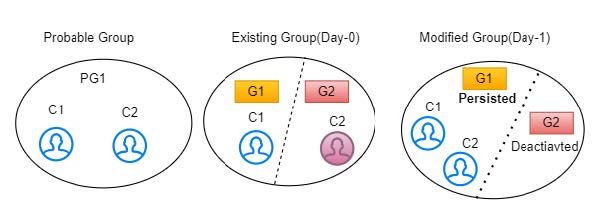

Case 2: If number of entities are same between the groups
For example, G1 has C1 entity and G2 has a C2 entity. After the Day 1 batch execution, if C2 entity matches with an existing group then C2 will be merged into the existing group with same global id is persisted and G2 will be deactivated.
Figure 4-21 Merge Action for Lowest Global ID

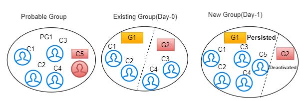

Merge and Add
Existing group elements are a subset of probable group elements, and the number of elements in the probable Group is more than the existing Group. Extra elements in the probable Group do not have any global id assigned yet, and standard elements have different global IDs assigned already. Common elements are merged into a single group, and new elements are added to the Group with existing global id is persisted.
You can manually persist the existing global id based on your requirement, only if F_PERSIST_GUID flag is set to True and F_MANUAL_APPROVAL flag is set to True/False in the FCC_ER_GUID_PERSIST_CONFIG table in the ER schema.
For more information about manually persisting the existing global id, see Persisting the Global Party ID through the Manual Action section in the OFS Compliance Studio User Guide.

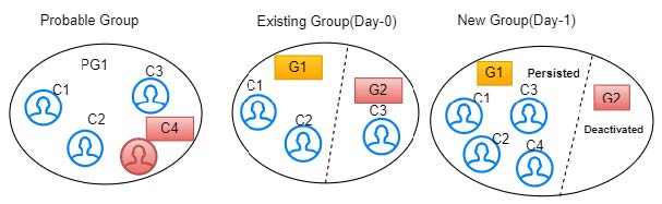

For example, G1 has C1 and C2 entities, G2 has C3 entity. After the Day 1 batch execution, if C4 entity is added newly and C3 entity got changed then common entities are merged into a single group and a new entity is added to the group with existing global id (G1 has C1, C2, C3, and C4 entities) is persisted and G2 will be deactivated.
Figure 4-22 Merge and Add Action for most Number of Entities
For example, G1 has C1 and C2 entities, G2 has C3 and C4 entities. After the Day 1 batch execution, if C5 entity is added newly and C4 entity got changed then common entities are merged into a single group and a new entity is added to the group with existing global id (G1 has C1, C2, C3, C4 and C5 entities) is persisted and G2 will be deactivated.
Figure 4-23 Merge and Add Action for Lowest Global ID

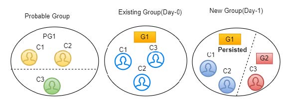

For example, G1 has C1, C2, and C3 entities. After the Day 1 batch execution, if C3 entity is not matched with the existing entities of the group then C3 will be split into a new group. G1 has C1 and C2 entities with existing global id is persisted and G2 has C3 entity with new global id assigned.
Figure 4-24 Split Action for most Number of Entities

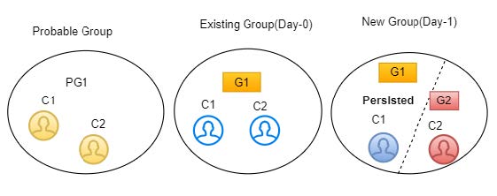

For example, G1 has C1 and C2 entities. After the Day 1 batch execution, if C2 entity is not matched with the existing entities of the group (regardless which entity was changed) then C2 will be split into a new group. G1 has C1 entity with existing global id is persisted and G2 has C2 entity with new global id assigned.
Figure 4-25 Split Action for Lowest Global ID

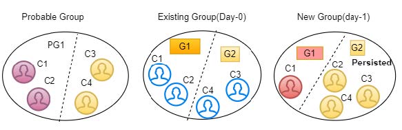

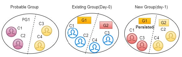

Split and Merge
After applying merging rules criteria, if multiple groups are created for elements of a probable group, these elements are also a subset of existing group elements. The number of elements in both probable and existing groups is the same, and different global ids are assigned to elements in the existing Group,then probable group elements are split into different groups and merged, satisfying the same ruleset criteria with existing global id is persisted for one group and new global id assigned to another group.
For example, G1 has C1 and C2 entities and G2 has C3 and C4 entities. After the Day 1 batch execution, if C2 matches with C3 and C4 then C2 will be split separately and merged with C3 and C4 respectively. G1 has C1 with a new global id assigned and G2 has C2, C3 and C4 entities with existing global id is persisted.
Figure 4-26 Split and Merge Action for more Number of Entities
For example, G1 has C1 and C2 entities and G2 has C3 and C4 entities. After the Day 1 batch execution, if C1 matches with C3 and C2 matches with C4 then C3 and C4 will be split separately and merged with C1 and C2 respectively. G1 has C1 and C3 entities with existing global id is persisted and G2 has C2 and C4 entities with a new global id assigned.
Figure 4-27 Split and Merge Action for Least Global ID

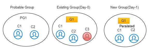

Delete
If an element exists in the existing group, but the same element does not belong to any probable group and does not exist in the customer/entity dataset, it is deleted from the existing group with same global id is assigned to the Group. If the deleted record is part of STG_DELETED_PARTIES_PRE table then underlying customers will also be deleted.
For example, G1 has C1, C2, and C3 entities. After the Day 1 batch execution, if C3 is deleted from the existing group then G1 has C1 and C2 entities with same global id is persisted.
