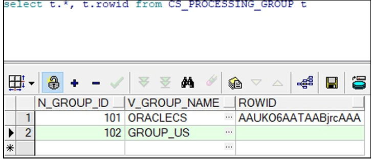

  1. Make an entry in the cs_processing_group table in the N_GROUP_ID and V_GROUP_NAME columns. For example, 102 and GROUP_US.
    Figure 4-39 Developer window
    This image displays the Developer window.

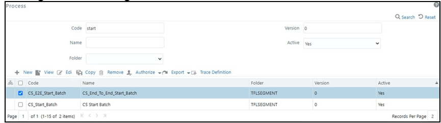

  4. Search for Start in the Code field and select CS_E2E_Start_Batch.
    Figure 4-40 Process page
    This image displays the Process page.

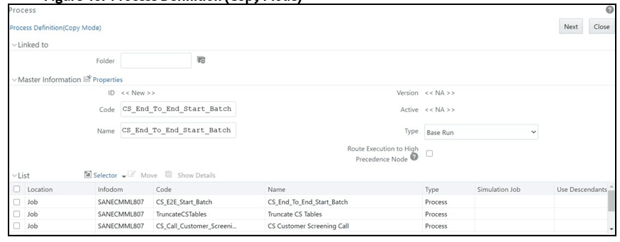

  5. Click Copy.
    The Process page opens in Copy mode.
    Figure 4-41 Process Definition (Copy Mode)
    This image displays the Process Definition (Copy Mode).

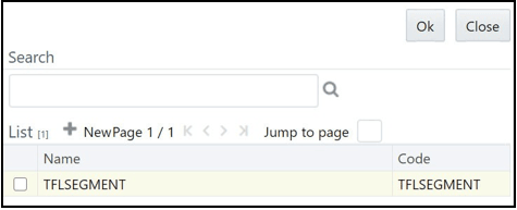

  6. In the Folder field, click Folder and then select TFLSEGMENT.
    Figure 4-42 Folder Selector
    This image displays the Folder Selector.

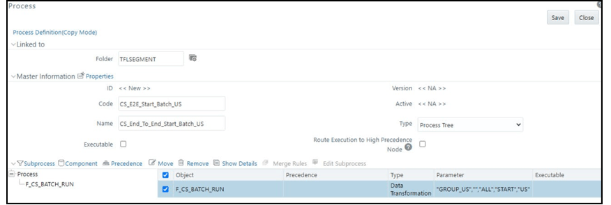

  7. In the Name field, change the job name to include the Jurisdiction Code. For example, CS_Data_Load_Event_Generation_US.
  8. Select F_CS_BATCH_RUN.
    Figure 4-43 Process Definition (Copy Mode)
  9. Select Component.

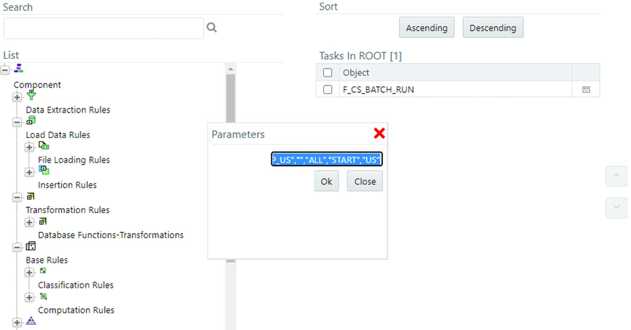

  10. In the Parameters window, select the F_CS_BATCH_RUN task and then click drop-down list. Change the parameter ORACLECS to the entry made in the cs_processing_group table and the parameter CS to the Jurisdiction Code. For example, "GROUP_US","","ALL","START","US".
    Figure 4-44 Component Selector window
    This image displays the Component Selector window.
  11. Click OK to close the Parameters window.
