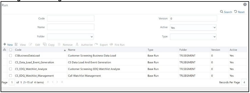

  2. Click Common Tasks, then click Rule Run Framework, and then click Run.
    The Run page is displayed.
    Figure 4-45 Run page
    This image displays the Run page.

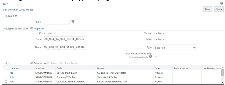

  3. Search for Start in the Code field and select CS_End_To_End_Start_Batch.
  4. Click Copy.
    The Run page opens in Copy mode.
    Figure 4-46 Run Definition (Copy Mode) page
    This image displays the Run Definition (Copy Mode) page.

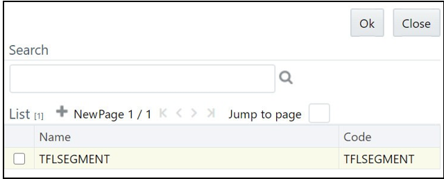

  5. In the Folder field, click Folder and then select TFLSEGMENT.
    Figure 4-47 Folder Selector

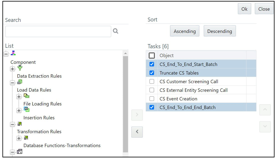

  8. In the Component Selector page, first select the CS_End_To_End_Start_Batch, CS_End_To_End_End_Batch, and Truncate CS Tables tasks(in that order) from the Tasks table and then click to move them to the List table.
    The tasks are moved to the Processes node.
    Figure 4-48 Component Selector
    This image displays the Component Selector.
    Ensure that you remove the Truncate CS tables job to prevent the removal of data. If, by mistake, you run the Truncate CS tables job, you can run the CSBusinessDataLoad job to reload data in the table.
  9. Replace these tasks with the task created in Step 17, that is, CS_Data_Load_Event_Generation_US.
    If you do not make this change, no data is loaded in the tables.
