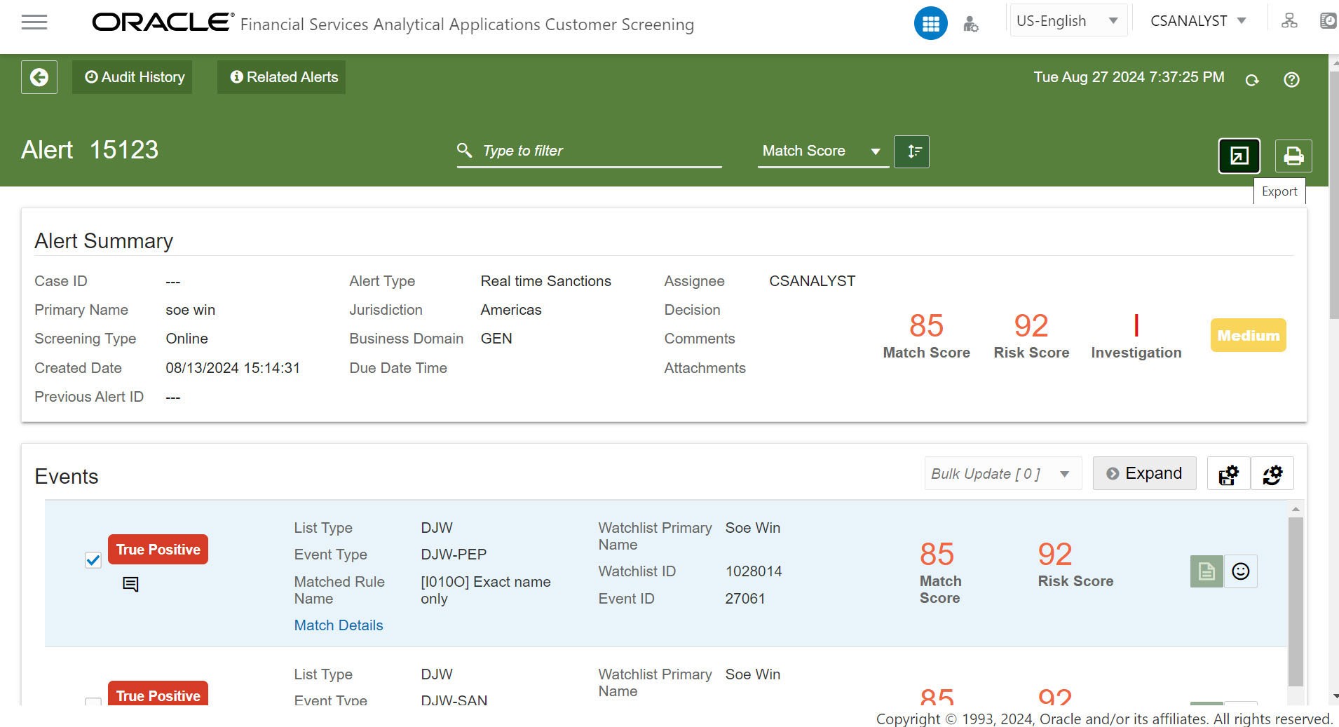

This topic displays the list of events along with their details in the Alert in the following components:
  • List Type
  • Event Type
  • Matched Rule Name
  • Watch List Primary Name
  • Watch List ID
  • Event ID
  • Match Score
  • Risk Score
  • Edit Comments Icon
Click on the Select All check box to select all the event records for the bulk update. The Select All option is configurable. To enable and disable Select All option, see the Application Level Configuration section in OFS Customer Screening Administration Guide.
To Customize the number events records displayed per page in the event table, enter the number in the Records Per Page entry box. The value must be between 5 and 100.
You can click the Expand button to expand the event page and view the event records (Records per Page) simultaneously. Click on the Collapse button to collapse the event record. You can save the preference by clicking the Save Save icon and click the Clear Clear icon for the default view.
Click on Match Details to display all the matched parameters of the event listed in the events table.

Exporting Event Details
Once you click the export icon, the event details of the alert is exported into excel.
Figure 3-22 Exporting Event Details
