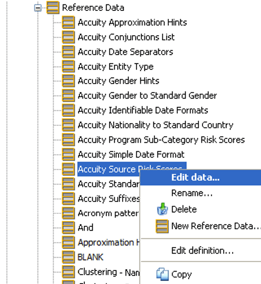

  3. Expand the Reference Data node.
  4. Right-click Accuity Source Risk Scores and select Edit data.
    This image displays the Accuity Source Risk Scores options

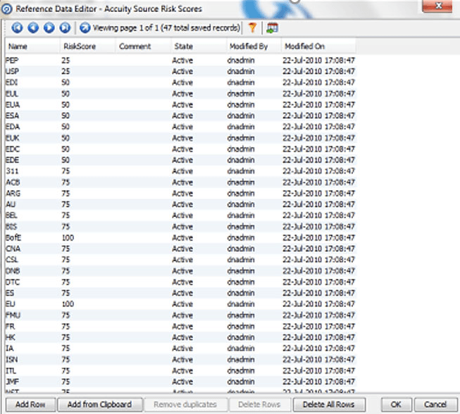

  5. In the Reference Data Editor – Accuity Source Risk Scores window, the risk score appears in editable mode.
    Figure 4-38 Reference Data Filters for Accuity
    This image displays the RReference Data Filters for Accuity.
    If you edit the risk scores, you must rerun the Download, Prepare, Filter and Export All Lists jobs in the Watch list Management project and the MAIN job in the Customer- Screening project in EDQ. Until this is done, the generated matches will not show the new risk scores. For more information on how to view the jobs, see Analyzing the Data Quality of Customer Data and External Entity.
