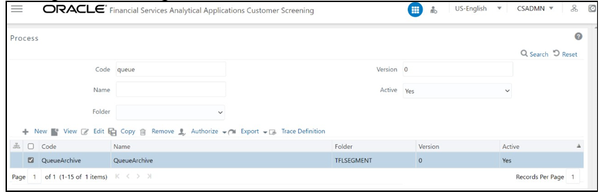

  1. Log on to the Customer Screening application.
  2. Click Common Tasks, then click Rule Run Framework, and then click Process.
    The Process page is displayed.
  3. Search for Queue in the Code field and select Queue Archive.
    Figure 3-8 Process Page
    This image displays the Process page.

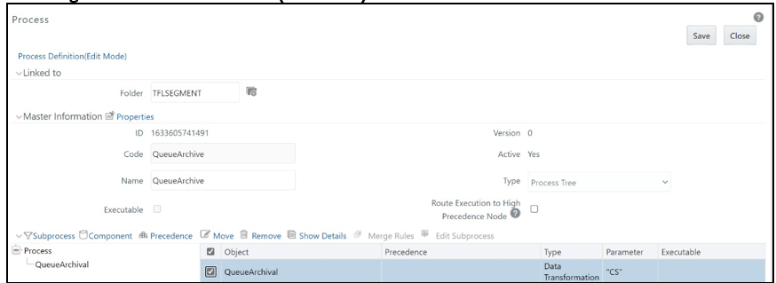

  4. 4. Click Edit. The Process page opens in Edit mode.
    Figure 3-9 Process Definition (Edit Mode)
    This image displays the Process Definition (Edit Mode).
  5. Select the QueueArchival object and then select Component.
  6. In the Parameters window, select the QueuArchival task and then click drop-down list. By default the parameter value will be selected as “TF”. Change the parameter to “CS”.
    Figure 3-10 Component Selector window
    This image displays the Component Selector window.
  7. Click OK to close the Parameters window.
  8. Click OK.
  9. Click Save.
    A confirmation message appears, click Yes to save the definition as a new version. A successful message appears, click Close.
