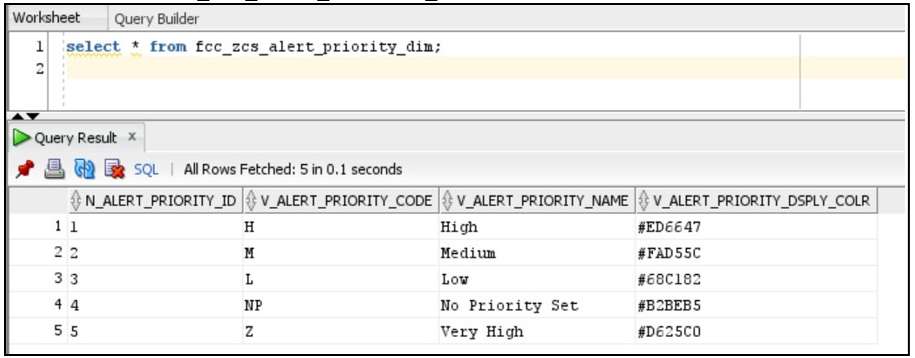

  1. Access the Atomic Schema and access the FCC_ZCS_ALERT_PRIORITY_DIM table.
  2. Change the following parameter value:
    • N_ALERT_PRIORITY_ID
    • V_ALERT_PRIORITY_CODE
    • V_ALERT_PRIORITY_NAME
    • V_ALERT_PRIORITY_DSPLY_COLR
    Figure 3-5 FCC_ZCS_Alert Priority_DIM_table
    This image displays the FCC_ZCS_Alert Priority_DIM_table.
    MERGE INTO FCC_ZCS_ALERT_PRIORITY_DIM T USING (
    SELECT '4' N_ALERT_PRIORITY_ID, 'B' V_ALERT_PRIORITY_CODE, 'Lower
    Medium' V_ALERT_PRIORITY_NAME, '#25C0D6' V_ALERT_PRIORITY_DSPLY_COLR
    FROM DUAL) S
    ON ( T.N_ALERT_PRIORITY_ID = S.N_ALERT_PRIORITY_ID )
    WHEN MATCHED THEN UPDATE SET T.V_ALERT_PRIORITY_CODE =
    S.V_ALERT_PRIORITY_CODE, T.V_ALERT_PRIORITY_NAME =
    S.V_ALERT_PRIORITY_NAME, T.V_ALERT_PRIORITY_DSPLY_COLR =
    S.V_ALERT_PRIORITY_DSPLY_COLR
    WHEN NOT MATCHED THEN INSERT
    (N_ALERT_PRIORITY_ID,V_ALERT_PRIORITY_CODE,V_ALERT_PRIORITY_NAME,V_ALERT
    _PRIORITY_DSPLY_COLR)
    VALUES
    (S.N_ALERT_PRIORITY_ID,S.V_ALERT_PRIORITY_CODE,S.V_ALERT_PRIORITY_NAME,S
    .V_ALERT_PRIORITY_DSPLY_COLR)

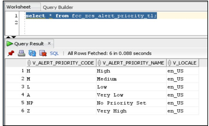

  3. Access the FCC_ZCS_ALERT_PRIORITY_TL table.
  4. Change the following parameter value:
    • V_LOCALE
      The FCC_ZCS_ALERT_PRIORITY_DIM table and FCC_ZCS_ALERT_PRIORITY_TL table must have the same parameter value entry.
    Figure 3-6 FCC_ZCS_Alert_Priority_TL
    This image displays the FCC_ZCS_Alert_Priority_TL.
    MERGE INTO FCC_ZCS_ALERT_PRIORITY_TL T USING (
    SELECT 'B' V_ALERT_PRIORITY_CODE, 'Lower Medium' V_ALERT_PRIORITY_NAME,
    'en_US' V_LOCALE FROM DUAL) S
    ON ( )
    S.V_ALERT_PRIORITY_NAME, T.V_LOCALE = S.V_LOCALE
    (V_ALERT_PRIORITY_CODE,V_ALERT_PRIORITY_NAME,V_LOCALE)
    VALUES
    (S.V_ALERT_PRIORITY_CODE,S.V_ALERT_PRIORITY_NAME,S.V_LOCALE)

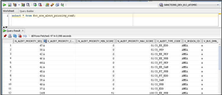

The priority for the new alerts are decided based on the score configured for the priority.
To define the priority and color code for the new alerts created based on the score, follow the below steps:
  1. Access the Atomic Schema and access the FCC_ZCS_ALERT_PRIORITY_CONF table.
    • N_ALERT_PRIORITY_SEQ
    • N_ALERT_PRIORITY_MIN_SCORE
    • N_ALERT_PRIORITY_MAX_SCORE
    • V_ALERT_TYPE_CODE
Figure 3-7 FCC_ZCS_Alert_Priority_Conf_table
This image displays the FCC_ZCS_Alert_Priority_Conf_table.
MERGE INTO FCC_ZCS_ALERT_PRIORITY_CONF T USING (
SELECT '37' N_ALERT_PRIORITY_SEQ, 'B' V_ALERT_PRIORITY_CODE, '81'
N_ALERT_PRIORITY_MIN_SCORE, '85' N_ALERT_PRIORITY_MAX_SCORE, 'CS_RT_SAN'
V_ALERT_TYPE_CODE, 'AMEA' V_JRSDCN_CD, 'a' V_BUS_DMN_LIST_TX FROM DUAL)
S
ON ( T.N_ALERT_PRIORITY_SEQ = S.N_ALERT_PRIORITY_SEQ )
S.V_ALERT_PRIORITY_CODE, T.N_ALERT_PRIORITY_MIN_SCORE =
S.N_ALERT_PRIORITY_MIN_SCORE, T.N_ALERT_PRIORITY_MAX_SCORE =
S.N_ALERT_PRIORITY_MAX_SCORE, T.V_ALERT_TYPE_CODE = S.V_ALERT_TYPE_CODE,
T.V_JRSDCN_CD = S.V_JRSDCN_CD, T.V_BUS_DMN_LIST_TX = S.V_BUS_DMN_LIST_TX
(N_ALERT_PRIORITY_SEQ,V_ALERT_PRIORITY_CODE,N_ALERT_PRIORITY_MIN_SCORE,N
_ALERT_PRIORITY_MAX_SCORE,V_ALERT_TYPE_CODE,V_JRSDCN_CD,V_BUS_DMN_LIST_T
X)
VALUES
(S.N_ALERT_PRIORITY_SEQ,S.V_ALERT_PRIORITY_CODE,S.N_ALERT_PRIORITY_MIN_S
CORE,S.N_ALERT_PRIORITY_MAX_SCORE,S.V_ALERT_TYPE_CODE,S.V_JRSDCN_CD,S.V_
BUS_DMN_LIST_TX)
