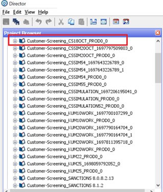

  1. Go to the EDQ project in the simulation EDQ director.
    Figure 9-12 EDQ Director
    EDQ Director

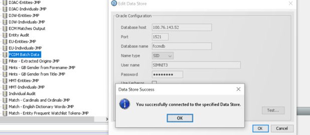

  2. Click Data Stores and click FCDM Batch Data. The Edit Data Store window is displayed.
  3. Give the simulation database details and click Test to connect to the specific Data Store.
  4. Click Ok.
    Figure 9-13 Edit Data Store Window

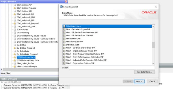

  5. Click Simulation EDQ project Staged Data and click on FCDM Customer Data. The data Store window is displayed.
    Figure 9-14 Data Store Window
    Data Store Window

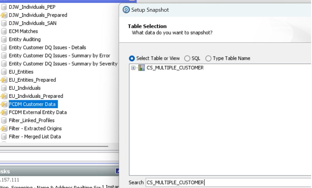

  6. Click Next. The Table Selection window is displayed.
    Figure 9-15 Table Selection Window

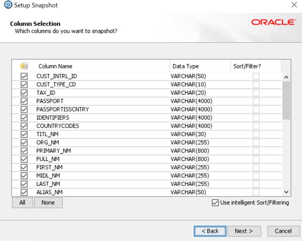

  7. Select the table or view and click Next. The Column Selection window is displayed.
    Figure 9-16 Column Selection
    Column Selection
  8. Search for cs_multiple_customer and select cs_multiple_customer.
  9. Click Next. The Snapshot Name window is displayed.
  10. Click Finish to save the updates.
