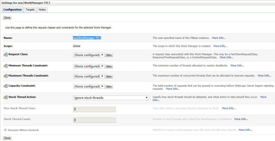

A Workmanager is using to retrigger failed messages. To create a Workmanager, follow these steps:
  • The Name field must have the value wm/WorkManager-TFLT
  • The Type field must have the value Work Manager
  • The Targets field must have the value AdminServer
  • The Scope field must have the value Global
  • The Stuck Thread Action field must have the value Ignore stuck threads
  • Click Save
    Figure 10-17 Workmanager screen 1

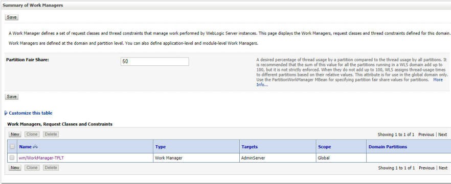

    Figure 10-18 Workmanager screen 2
