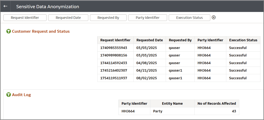

  5. Dashboard Sections:
    Figure 8-142 Right to Forget Dashboard
    • Customer Request and Status – Displays request details.
    • Audit Log – Tracks affected records for accountability.
  6. RTF Customer Request Table – Stores details of each RTF request, including:
    • Request Identifier – Unique request number.
    • Requested Date – Date of submission.
    • Requested By – Username of requester.
    • Party Identifier – Entity involved.
    • Execution Status – Indicates success or failure.
  7. Reviewing the Audit Log:
    • Party Identifier – Matches request ID.
    • Entity Name – Type of entity affected.
    • Records Affected – Number of modified records.
  8. Filtering and Searching Requests:
    • Use filters (e.g., Date, Requested By, Status) to narrow results.
    • Select a request to view details in the Audit Log.
  9. Verifying Execution Status & Impact:
    • If successful, check affected records.
    • If failed, troubleshoot using system logs.
