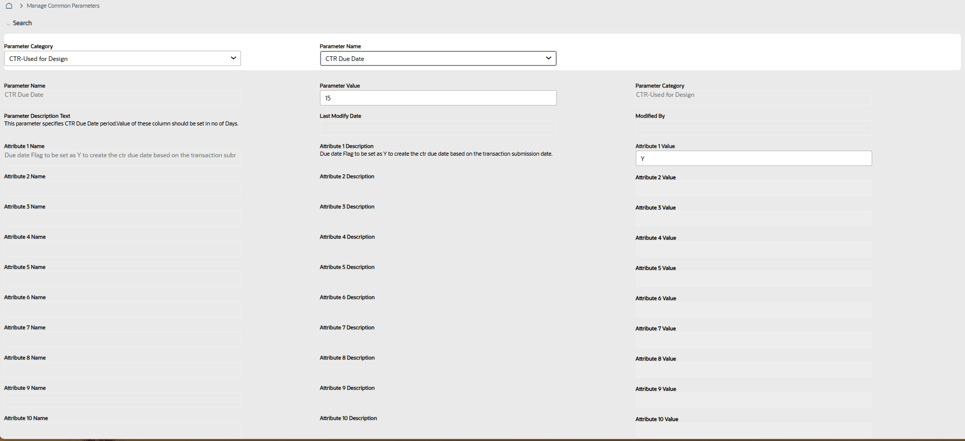

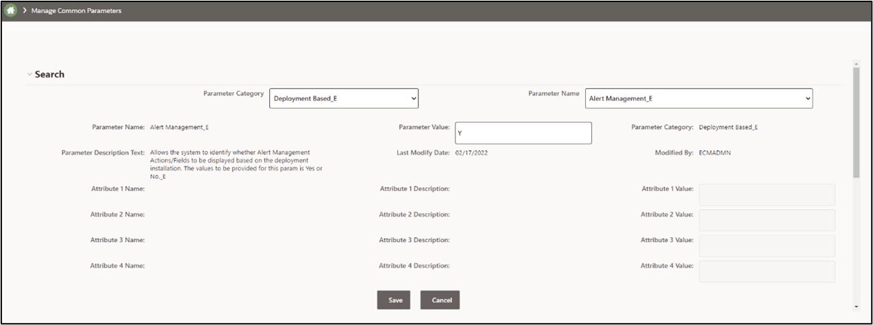

  1. Open the Manage Common Parameters screen.
  2. Select UI Display from the Parameter Category drop-down list.
  3. Select Base Currency from the Parameter Name drop-down list.
  4. Edit the parameter as shown below.
