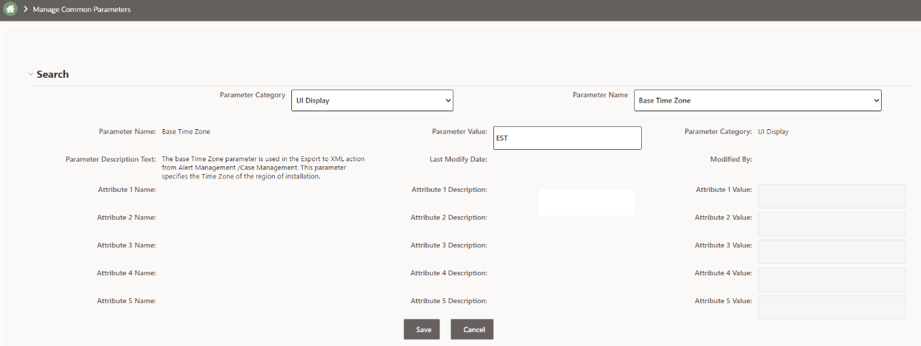

The Base Time Zone parameter is used in the Export to XML action from Case Management. You can modify the default Base Time Zone through the Manage Common Parameters screen (Refer Configuring Base Time Zone figure below).
Modifying Time Zone
To modify the base time zone, follow these steps:
  1. Open the Manage Common Parameters screen.
  2. Select UI Display from the Parameter Category drop-down list.
  3. Select Base Time Zone from the Parameter Name drop-down list.
    Figure 14-2 Configuring Base Time Zone
    This image shows the Configuring Base Time Zone.
  4. Edit the required parameter details and click Save. A confirmation dialog box appears asking: Would you like to Save these actions?
  5. Click OK. A confirmation dialog box appears with the message: Update Operation Successful.
  6. Click OK. The Manage Common Parameters page is displayed.
