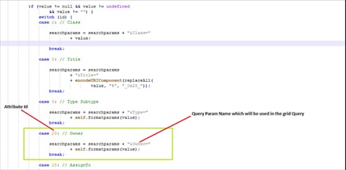

  2. Add the search parameter passing code for respective Attribute ID under self.buttonClickSimpleSearch function.
    Figure 20-11 self.buttonClickSimpleSearch
    THis image shows the attribute ID.

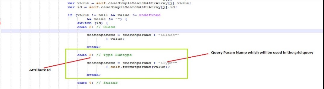

  3. Add the search parameter passing code for respective Attribute ID under self.buttonClickSearch function.
    Figure 20-12 Search Parameter Passing Code
    This image shows the Search Parameter Passing Code screen.

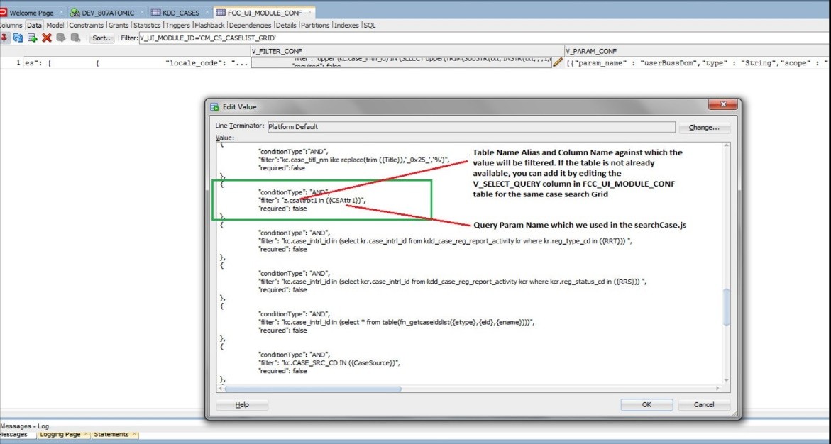

  4. Configure the search parameter in the FCC_UI_MODULE_CONF table for V_UI_MODULE_ID='CM_CS_CASELIST_GRID'. To configure, the V_FILTER_CONF entry should be updated with the JSON object for the new search parameter.
    Figure 20-13 FCC_UI_MODULE_CONF table
    This image shows the FCC_UI_MODULE_CONF table attributes.

  2. Add the search parameter passing code for respective AttributeId under self.buttonClickSearch function.
    Figure 20-15 self.buttonClickSearch
    This image shows the self.button ClickSearch attribute.

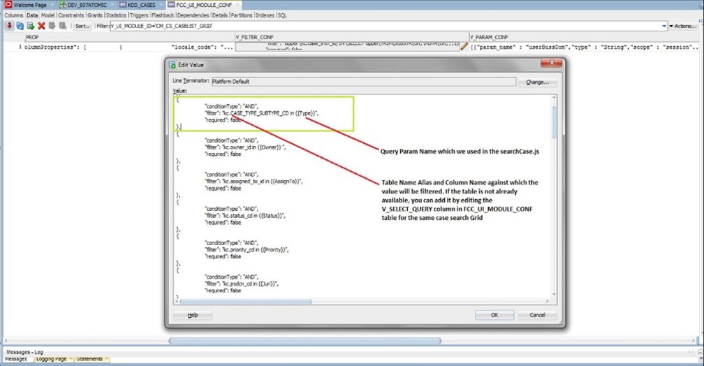

  3. Configure the search param in the FCC_UI_MODULE_CONF table for V_UI_MODULE_ID='CM_CS_CASELIST_GRID.To configure, the V_FILTER_CONF entry should be updated with the JSON object for the new search parameter.
    Figure 20-16 New search parameter
    This image shows the new search parameter screen.

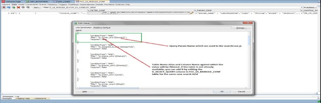

  2. Configure the search param in the FCC_UI_MODULE_CONF table for V_UI_MODULE_ID='CM_CS_CASELIST_GRID. To configure, the V_FILTER_CONF entry should be updated with the JSON object for the new search parameter.
    Figure 20-18 Configure Search Parameter
    This image shows the Configure Search Parameter screen.

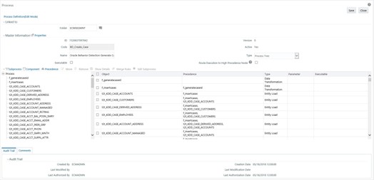

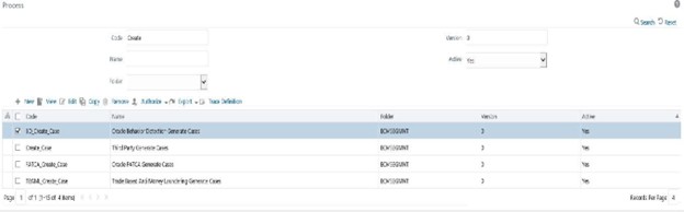

  5. Click Process. The Process window is displayed with the available Processes. Search for ‘Create process’. The list of processes will be displayed.
    Figure 20-24 BD_Create_Case process
    This image shows the BD_Create_Case process screen.
    1. Select the BD_Create_Case and click Edit.
      Figure 20-25 Edit BD_Create_Case process
      This image shows the Edit BD_Create_Case process screen.

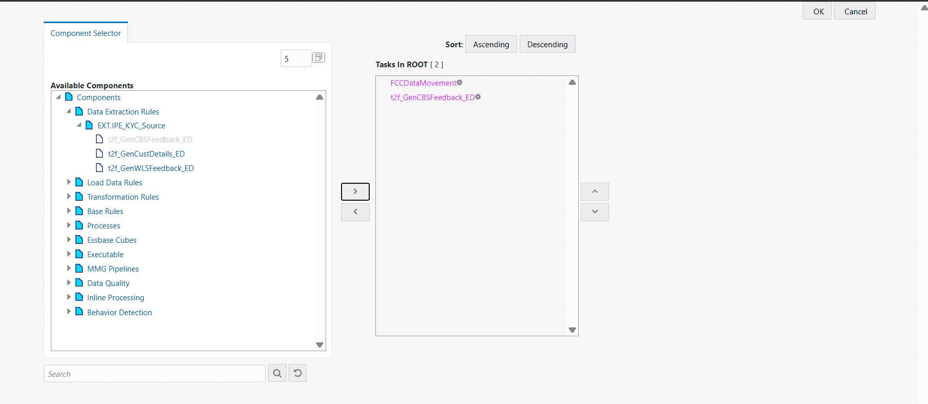

    2. Click Component. The Component Selector window is displayed. Under Transformation Rules, select CaseTitle and move it to the task list.
      Figure 20-26 CaseTitle Component
      This image shows the CaseTitle Component screen.
