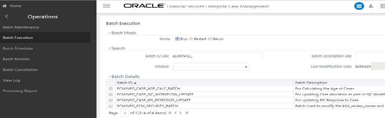

Executing Case Age Calculation Batch
To execute the Case Age Calculation batch <INFODOM>_CASE_AGE_CALC_BATCH, follow these steps:
  1. Login as ECM Administrator.
  2. Navigate to the Common Tasks option.
  3. Select Operations.
  4. Click Batch Execution.
    Figure 20-2 Batch Execution
    This image shows the Batch Execution screen.

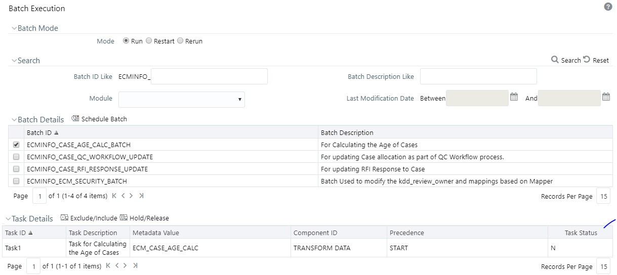

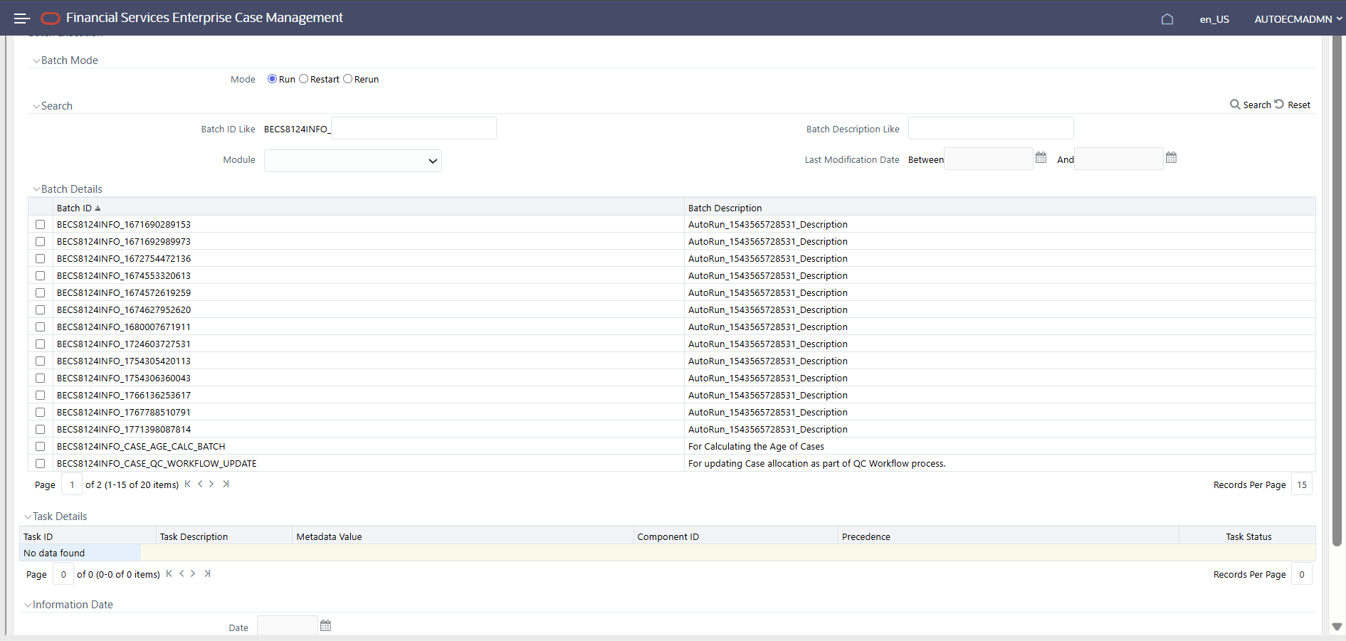

  5. Search for <INFODOM>_CASE_AGE_CALC_BATCH (batch and enter the Information Date (MIS date) using Calendar. Click Execute Batch.
    Figure 20-3 Execute Batch
    This image shows the Execute Batch screen.
  6. Click OK on the confirmation box. A batch execution triggered message is displayed.
  7. To view the status of the batch, navigate to Batch Monitor under Operations.
