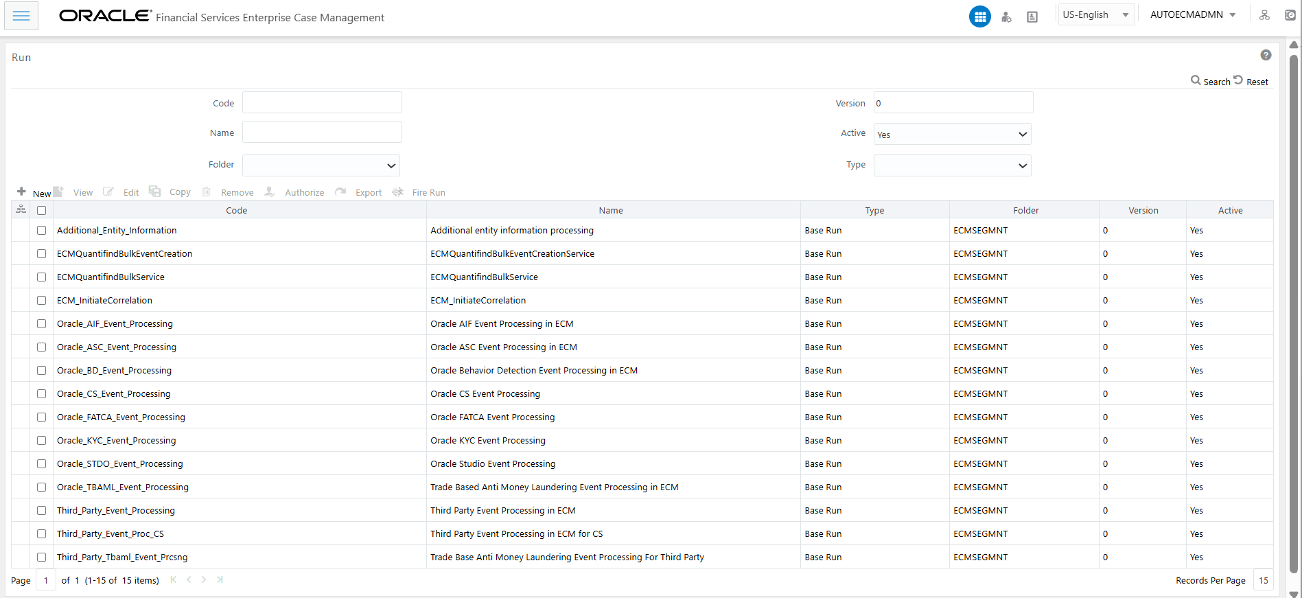

  2. Go to the Common Tasks section. Select the Rule Run Framework.
  3. Click Run. The Run window is displayed with the available Processes.
    Figure 6-1 Application List
    This image shows the Application List.

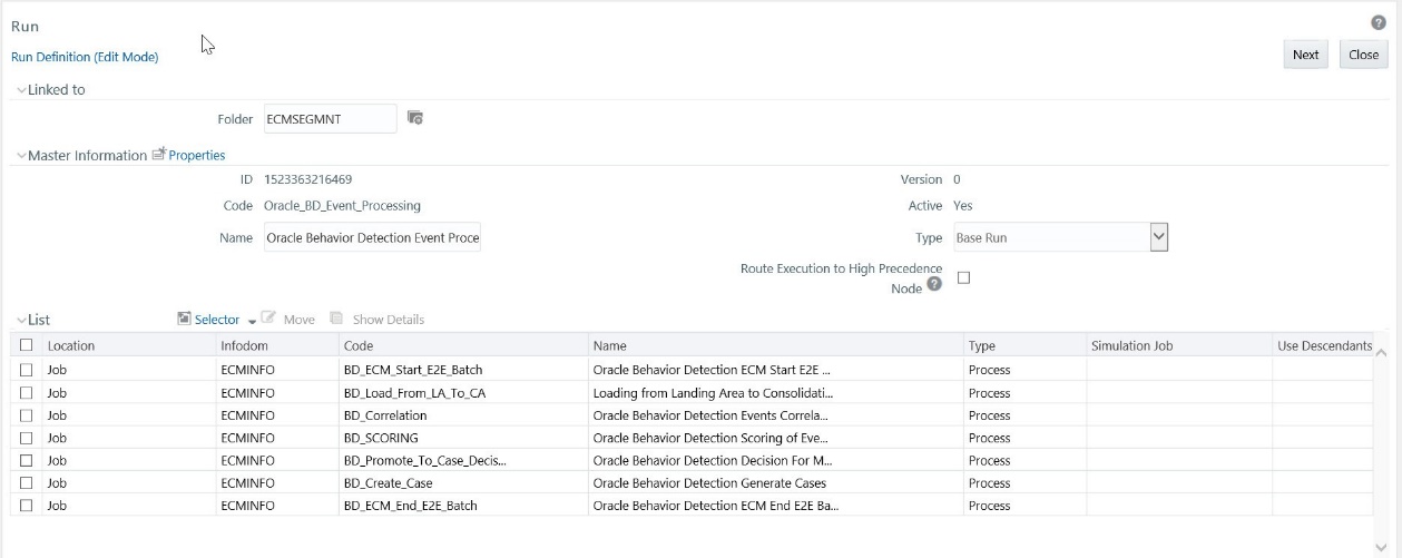

  4. Go to the List section. Select an application for example (Oracle_BD_Event_Processing). The list of processes for the selected application is displayed.
    Figure 6-2 List of Processes screen
    This image shows the List of Processes screen.

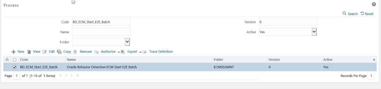

  5. Navigate to Process Summary Page and search for BD_ECM_Start_E2E_Batch.
  6. Select the batch BD_ECM_Start_E2E_Batch and click Edit.

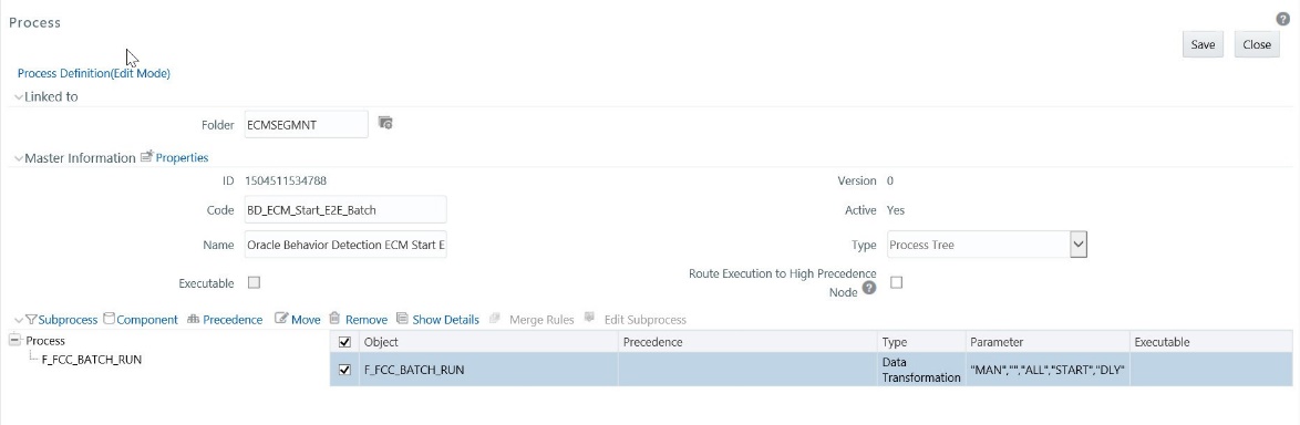

    The Process Definition page is displayed.
    Figure 6-4 Process Definition page
    This image shows the Process Definition page.

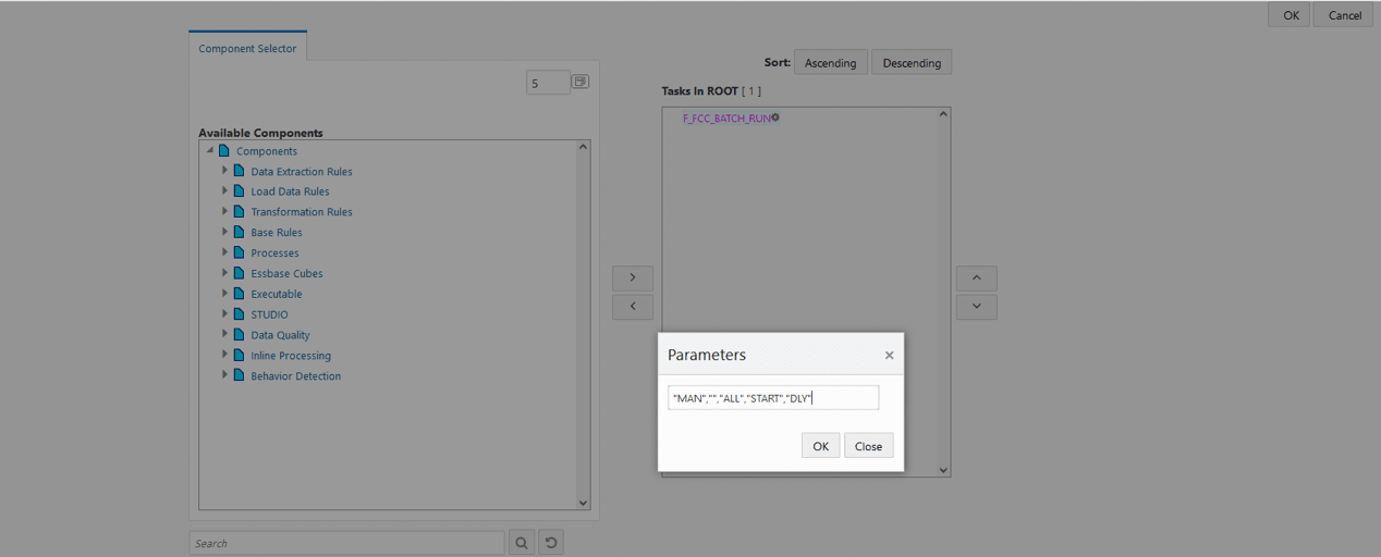

  7. Click Component. The Component Selector window is displayed.
  8. Under the Tasks In ROOT section, right-click on the required batch, and then click Add Parameters. The Parameters window is displayed.
    Figure 6-5 Parameters
    This image shows the Parameters.
    The following are default parameters: "MAN","","ALL","START","DLY".
    • MAN:is the group name. Modify the name of the group as mentioned in FCC_PROCESS- ING_GROUP table. For example: E2E BATCH ALLSOURCE
    • "" Source Batch for Correlation
    • ALL: is the component that can be modified if required
    • START: is used to start the batch
    • DLY: is Data Origin
    The following is an example of a parameter:
    "E2E BATCH ALL SOURCE","","ALL","START","IND"
  9. Modify the parameters and click OK.

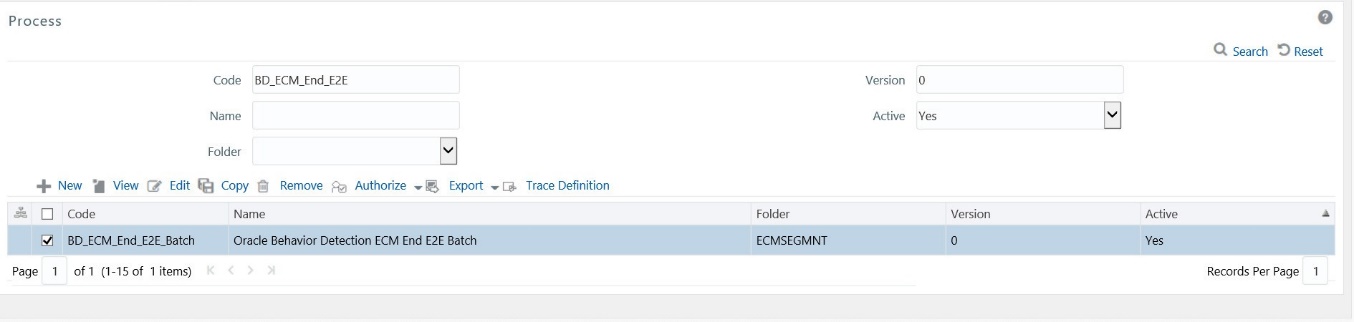

  1. Navigate to the Process Summary page and search for End Batch, for example: BD_ECM_End_E2E.
    Figure 6-6 Process
    This image shows the Process.
  2. Select the batch, and click Edit. The Process Definition page is displayed.

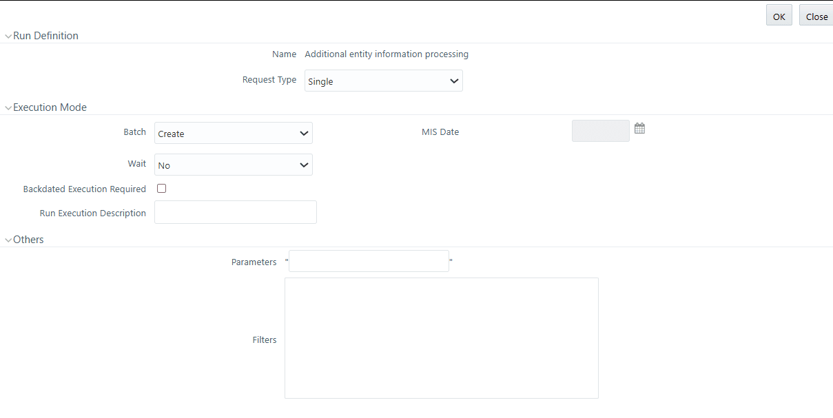

Executing a Batch Run
If you have 10 days of data, then the ECM batch has to be executed from day-01 onwards.
To access and execute the batch run, follow these steps:
  1. Navigate to Enterprise Case Management Application.
  2. Go to the Common task section. Select the Run Rule Framework.
  4. Select the Application process from the Run definition page list that is to be executed and click Fire Run. The Fire Run window is displayed.
    Figure 6-7 Fire Run window
    This image shows the Fire Run window.
  5. Enter details as described in the following table:
    Table 6-1 Adding Fire Run Details
    Fields Description
    Request Type
    Select Request Type based on the following options:
    • Single: If the batch must be executed once.
    • Multiple:If the batch must be executed multiple times at different intervals.
    Batch
    Select Batch. It has the following options:
    • Create
    • Create &Execute
    From these options, select Create & Execute
    Wait
    Select Wait. It has the following options:
    • Yes: This executes the batch after a certain duration. Enter the duration as required.
    • No: This executes the batch immediately.
    Filters
    Enter the filter details.
    • $MISDATE option can be used to execute the run for that particular day. The format for it to enter the filter details is: to_date(<ACTIVITY_TABLE_NAME>.<ACTIVITY_DT_COL>)=$MISDATE
    • For the $MISDATE option:
      • For either Date or Timestamp datatypes, to_date is mandatory for the filter.
      • Activity Table Name and Activity Column Name should be in the capital.
  6. Click OK to run the batch. The message: Batch Execution is in progress is displayed.
  7. Click Close.
