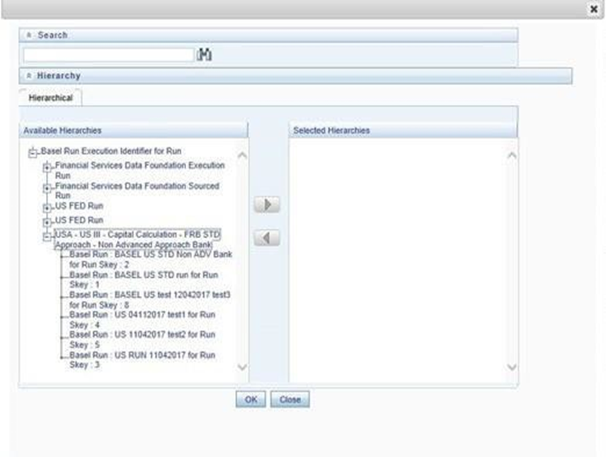

- Enter the Run Execution Description. The BASEL Run Execution Identifier and FIC MIS Date is auto-populated from the BASEL Run report used.
- Click OK.
Resave Hierarchy HFSDF004 (FSDF BASEL Run Execution Identifier for Run) after BASEL execution for getting values in this BASEL Run Execution Identifier.Figure 31-1 Integration of BASEL and FSDF using approved BASEL Run Execution ID in FSDF Run
- Select only one BASEL Run from the Available Hierarchies for the execution and click OK.
