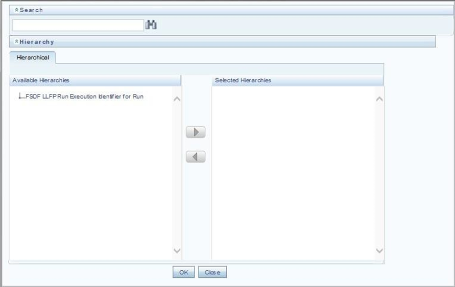

      Resave Hierarchy HFSDF007 (FSDF LLFP Run Execution Identifier for Run) after LLFP execution for getting values in this LLFP Run Execution Identifier.
      Figure 32-1 Integration of LLFP and FSDF using approved LLFP Run Execution ID in FSDF Run
      This illustration shows the integration of LLFP and FSDF using approved LLFP Run Execution ID in FSDF Run.
    7. Select only one LLFP Run from the Available Heirarchies for the execution and click OK.
