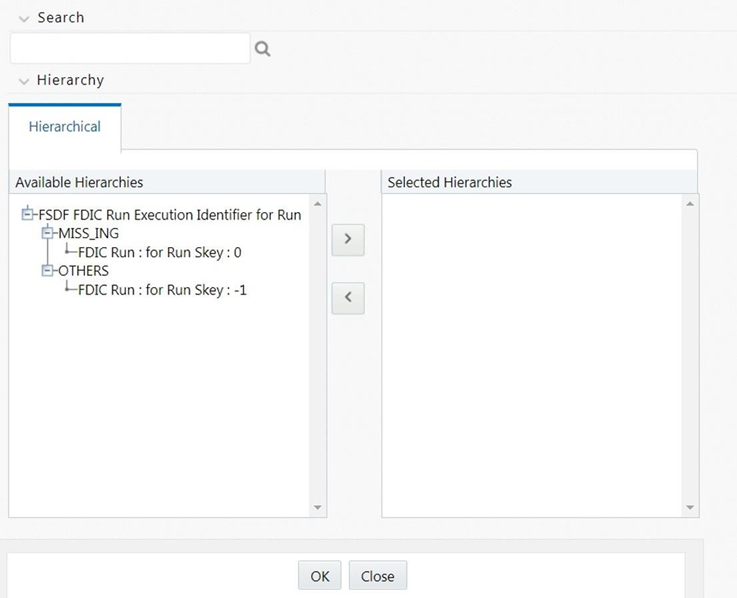

      After LRS execution, to get values in this LRS Run Execution Identifier, Resave Hierarchy HFSDF006 (FSDF LRS Run Execution Identifier for Run).
      Figure 33-1 Integration of LRS Pack and FSDF using approved LRS Pack Run Execution ID in FSDF Run
      This illustration shows the integration of LRS Pack and FSDF using approved LRS Pack Run Execution ID in FSDF Run.
    7. Select only one LRS Run from the Available Hierarchies for the execution and click OK.
