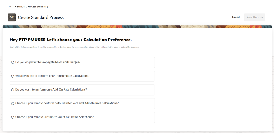

- From the LHS menu, select Operations And Processes, and then select Standard Process.
- Click Add to open the Create Standard Process Screen.
Figure 2-3 FTP Processing – Create Standard Process Screen 1
The Create Standard Process Screen 1 allows you to pick the type of calculations that you want to perform. Based on selected calculations, only relevant options will be displayed and wizard flow will guide the you to complete the set up. The options available are:
- Only Rate Propagation
- Only Transfer Rate Calculations
- Only Add-On Rate Calculations
- Both Transfer and Add-On Rate Calculations
- Customized Calculations Selection (Present all possible calculations combinations)
