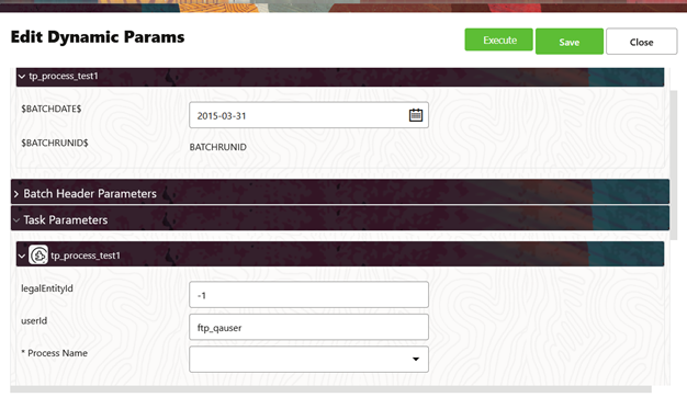

  9. From the LHS menu, select Operations and Processes, select Scheduler, and then select Schedule Batch; enter Batch Date and Legal Entity for which standard Process needs to be executed as follows:
    Figure 2-21 Edit Dynamic Params
    Edit Dynamic Params
  10. Follow the standard steps and schedule the Batch. For more information, see the Schedule Batch section.
